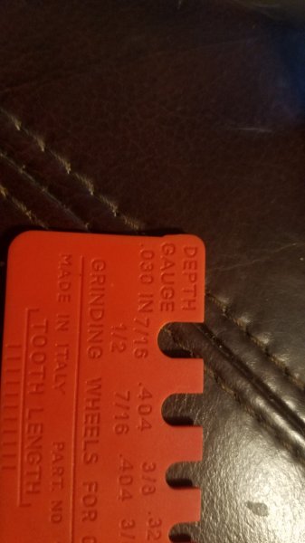

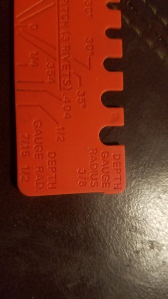

    20180415_110723.jpg The depth gauge measurement tool that came with my Oregon grinder states. .030 for 3/8 chain. .015 is definitely too high. 20180415_110708.jpg
