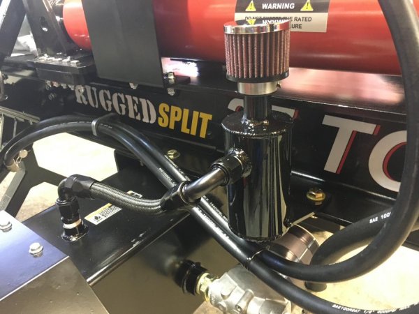

    I installed a breather tank with a larger hose going to it mounted above the tank on my rugged split. One of the big problems was the oil return is right below where the vent is located and with no baffles in the tank the turbulence of the oil on the return stroke actually causes the oil level to raise up directly below the vent. The tank is like what you would use on a race car and connect to the valve cover to vent that crankcase.
    Somewhere I have a picture and will try to find it. If I can I will post it.
    brenndatomu likes this.

    Here you go.
    This has worked absolutely perfect for me. Does not leak a drop and not a drop out of the drain valve that is installed in it. I have passed this along to other members here that had the same issues and the end result for them was the same. log splitter breather tank.jpg

    WOW, that sir is a work of art! I too wondered if the return location on mine combined with a lack of internal baffle caused part of my issue. Anyways, great work!

    On the return stroke is when the oil has the most turbulence in the tank , there is a larger amount of oil going back to the tank when cylinder is coming back because on the back-side the entire tube of the cylinder is full and there is no rod displacing area for the oil. It is kind of poor engineering when they built mine , if they located the fill on the other side of the tank as far away from the return as possible it would probably help if not cure the issue.
    You can do the same in a little less elaborate way with a street "L" fitting and a hose barb up to a tank. I had built a couple tanks for race cars and had the braided hose and hose ends in the shop from past projects so that's why I went that route. An inexpensive plastic tank is available from a place like Summit Racing or even on ebay.
    Most important is it worked and has not been an issue since.
    Hope this helps.
