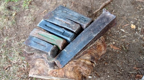

    Here are my wedges. I split by hand, and don't have the upper body strength to swing a maul, IMG_20170811_29126.jpg so I use these on everything. But I'm waiting to get my new saw before I tackle this oak again!

    I'll have to get a picture of my wedges. I also have an old maul head, of which the handle broke. As it has a wider taper than a regular wedge, it's handy to use to open up the split, to free up any stuck wedge that has bottomed out. I've had to use two wedges pressed together, but prefer the single wider maul head.
    You can probably get one from a yard sale some wheres, for cheap $'s of the handle is broken.

  11. Midwinter
    I have a horrible old good for nothing maul, and I never thought to use it that way. Now I will!
