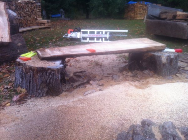

    Granberg also offers a dremel-type 12v grinder. The one that I have is called the G1012XT precision grinder. It's basically their 12v grinder, mounted onto the same hand-sharpening jig that they offer. About $80 bucks at TreeStuff. They have some diamond stones available there too, but I wasn't sure if they were right for the granberg, because it takes bits with a threaded shank. TreeStuff - Granberg Grind-N-Joint Bar Mounted Chain Grinder
    I like it a lot. That was a "normal" 30 degree chain, that I re-ground to 10 degrees for use as a milling chain. I was also able to do the rakers with it. It made for a very smooth cutting chain - before this, I always did my rakers by hand, and I'd usually end up with a bit of a bumpy ride, cause I wouldn't get them all even.
    Note the size of the chips I was getting in the foreground here. When I'm milling, they usually come out more like sawdust. I was quite impressed.
