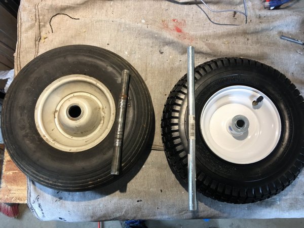

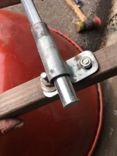

    This wheel barrel approx 30 years old. The wheel bearing broke and to my surprise, the inexpensive 13" replacement wheels for $12.99 with standard 5/8" diameter hole for standard 5/8" axle will not fit! So is there a cheap fix here???
    There are universal replacement wheels with a few different plastic bearings but for $30-$32 dollars. I did see a universal tire with a nice metal bearing that looks like it would fit my shaft which is about 11/16" in diameter but the wheel was 10" in diameter and I need a wheel that is 13" in diameter. Also the axle rod on my wheel barrel was very worn and measures approx 9.5 inches long. There is a wheel barrel hardware kit that has more parts than I need and costs $35-$45 dollars with the shipping. A new wheel barrel is $70-$100 dollars. So I decided to purchase a piece of 5/8" steel round 13.5" long and take a chance for only $5.48
    5/8" Steel Shaft for Rubber Rollers Redline Boat Trailer Parts 408400
    This shaft fits the new wheels perfectly!
    So I purchased this one from Harbor Freight!
    13 in. Heavy Duty Pneumatic Tire with White Hub

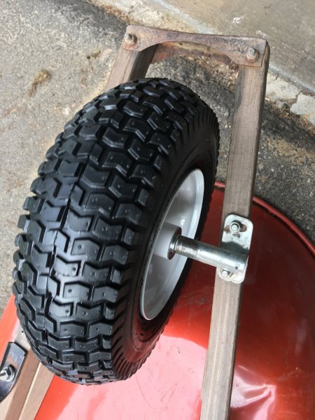

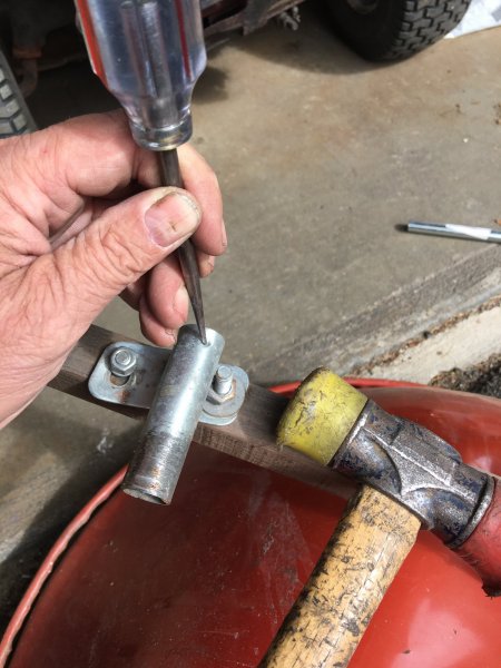

    However when placed in the wheel barrel axle rod end holders the slightly smaller diameter allows it to slip past the stops and fall out. Therefore, I took an Awl and hammer to the stop and banged it in further so it worked for the new axle rod!

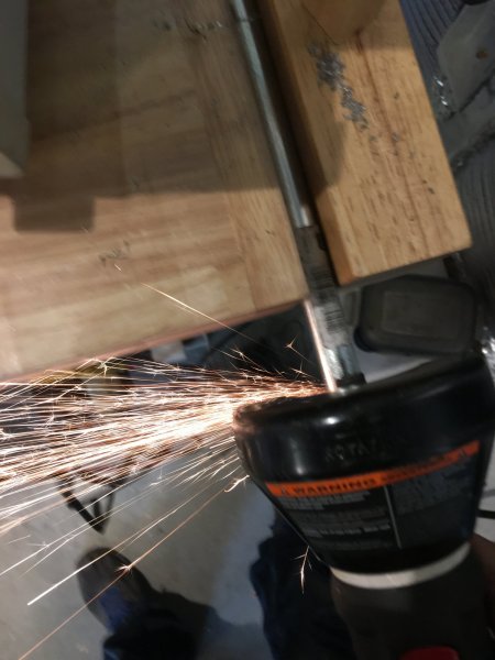

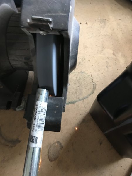

    Also cutting down the new rod with an air cutter took about 15 mins with grinding and wire brushing! See pics below!

    Pic 1 - Old wheel and axle left and new standard 5/8" wheel &!axle on right
    Part # of new axle rod is 86041
    Pic 2 - new shaft goes beyond stop
    Pic 3 - Hammer stop so it sticks inside more and prevents new shaft from falling out.
    Pic 4 - cutting new steel rod down to axle size
    Pic 5 - Grinding down cut end smooth

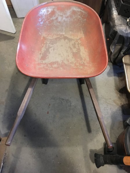

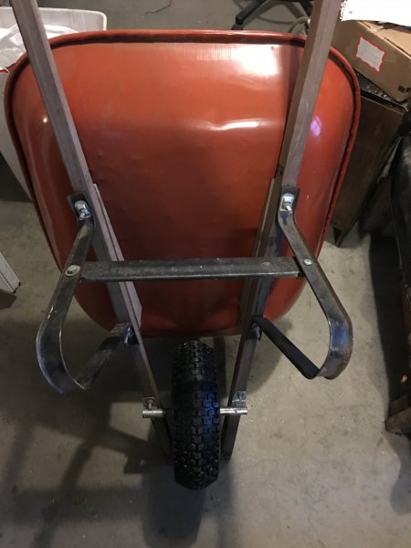

    Pic 6 - New wheel fits and works fine!
    Pic 7 - 8 Old red wheel barrel works like new!
