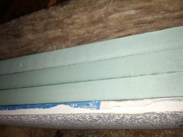

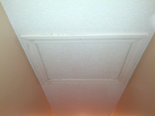

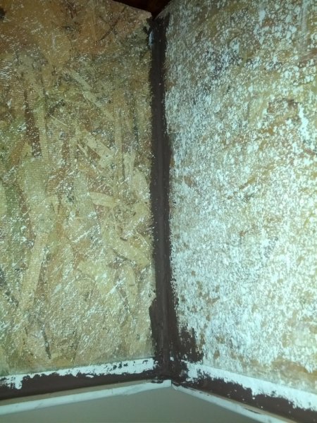

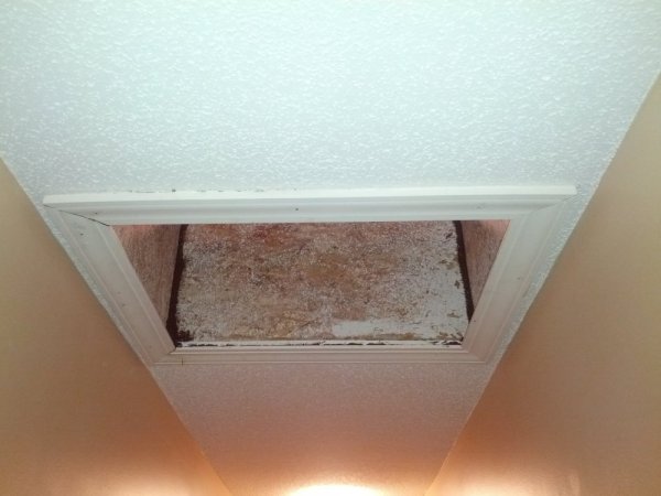

    Ok so I spent a bunch of time playing around with the attic access to figure out how I wanted to try to seal it and round one is done for now. First I pulled all the trim pieces down and put them back up after putting silicone all the way around where they would seal to the drywall. I then caulked the framed in access inside the attic and caulked the inside of the trim pieces. Next I glued 3 pieces of 1" thick foam down to the bottom side of the access drywall and placed rolled insulation on top of that and set the access in place.
    I think I am going to do one final thing after a trip to the hardware store. I am going to get some 1/4"-3/8" soft foam weatherstripping and place it on the back side of the trim pieces so the access lays against it flush when in place. Then I am going to place some small weights on the back of the drywall to make sure it presses down against it for a good seal. Any other suggestions?

  8. papadave
    Pretty sure the weight of all that will seal some soft foam weatherstripping.
    I'd say you did pretty good there.

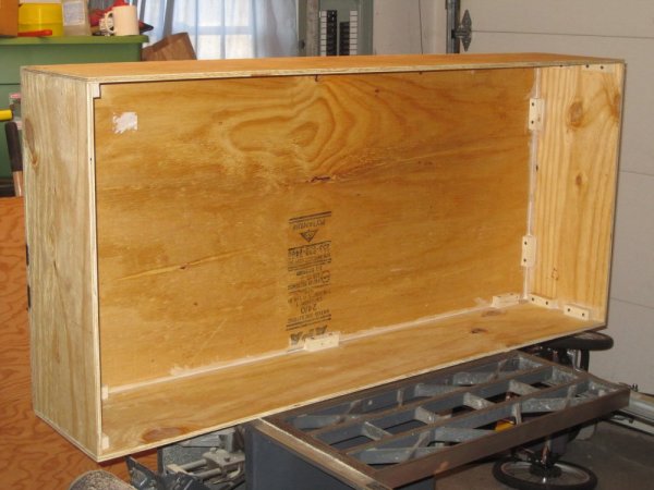

  15. stuckinthemuck
    stuckinthemuck
    3,247
    15,354
    Built a box to go over the top of some attic pulldown stairs in a rental house I had... Plywood and foamboard attached.. Built a similar one for my sister's house. Here's the basic box. Didn't get final pics of the whole thing installed. Did 4 inches of foam board on the side and 6 inches on the top. The big difference is made by cutting the airflow of warm air escaping to the attic. Not too hard to move for attic access when needed.

  16. fox9988
    fox9988
    2,710
    8,287
    NW Arkansas 72717
    That's almost exactly how I built my attic access, works great. When I get into the attic for Christmas decorations every winter, it's like being in a wind tunnel while standing in the access hole. Definitely best to stop the air leaks there.
