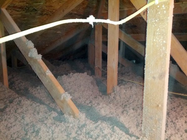

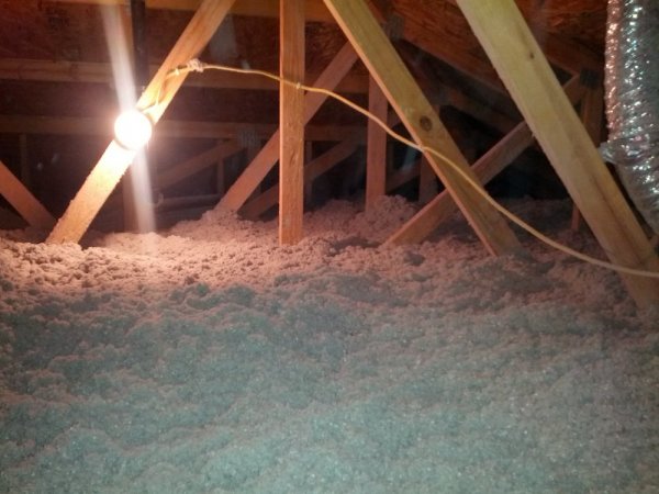

    Well we got it done! My dad had time to help this evening so we started at 4pm and finished cleaning up at 9PM. It was worse than I realized once I got up there and started crawling around! I was lucky to have 6-7 inches right around the attic access and the rest of the attic had less than 2 inched of insulation. There were section of rafters that were 8 feet long and had 0" insulation it was just bare drywall. I ended up going back and getting 25 more bags of insulation to finish up for a total of 100 bags for a 1150 square foot attic. It is now about 16" deep with a estimated R49 value:thumbs:. I am really really hoping this makes a MASSIVE difference in heating this house this winter! After realizing how bad it was I'm even more impressed with the T6 keeping up last winter!

    Here are a few finished pics

    How was it? Where did you put the blower? How did you communicate to your Dad when to load another bag and when to stop? Just trying to sort these issues out. I want to add some insulation to my own attic before winter sets in.

    I have a two story house and the blower was a good 100 foot from my attic access sitting in the driveway. Once I got upstairs and situated he turned it on and started dumping bags in. It doesn't come flying out super fast so it was no big deal to set the hose down and re-situate as necessary while it was still blowing. Every 1/2 hour or so he would throw a bunch in the hopper and walk up to see how it was going and then go back. Walkie talkies would work fine also but we really didn't need them. It was even less dusty than I expected.
