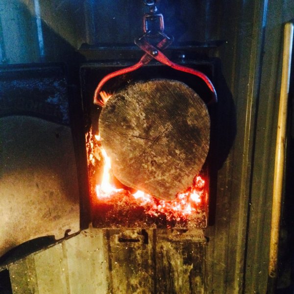

    Any pictures of your setup?
  6. JustWood
    JustWood Guest
    Only pic I got.
    I can get a pic of the bridge crane dad built today.
    He had a chain fall on the trolley and as he got older it was harder for him to operate . Couple years ago I bought an electric hoist and it's much easier.
    I rake coals to front and lay down a couple pallet boards or lumber cutoffs or slabs from a friends sawmill, lay in a monster and shove in with my foot or a bar.
    Farmchuck likes this.
  7. Farmchuck
    Farmchuck
    Dec 18, 2016
    1,769
    8,650
    Nepa
    Wow that’s a big piece o wood!
