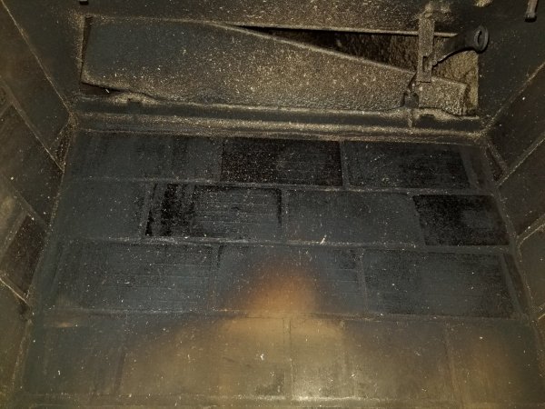

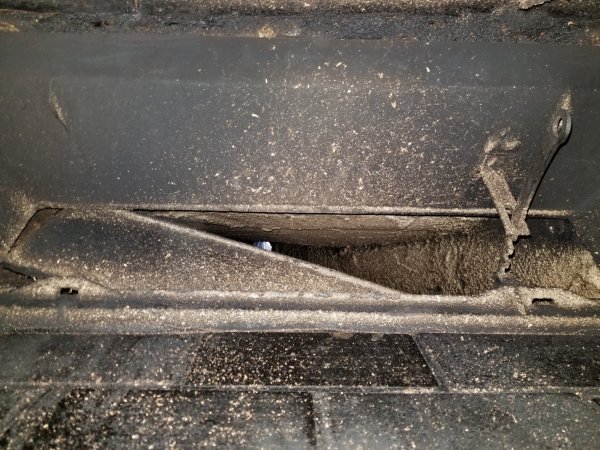

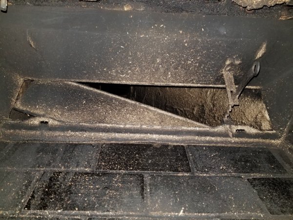

    You'll have questions one you see the damper. I did. If you can post up pics of your damper and get some measurements you'll be further on your way.
    What size pipe does the drolet you bought use?

    That's what I was thinking and wondering if I could get away with not having to do all that with an Oval liner. However 1st things 1st need to get my scared of heights butt up on the roof and measure the dang flue.
    As SWN stated it's a 6" here are some pic's I too below. It's 5" 3/4 just shy of the 6" so there is gonna be some cutting involved if I go round. Must say am a little nervous, but I have my brother in law to give me a hand he had to cut his and knock some bricks out.

    I think I just ovalized mine a tad and it went without cutting the damper.

    It's such a chore getting the flue pipe down the chimney... and I was working by myself. So, once it was in hole, a mallet and grinder were easier than taking 20 ft of razor sharp liner out. Also... I don't think I could have done that given the bend around the smoke shelf occurring so close to the stove top.
