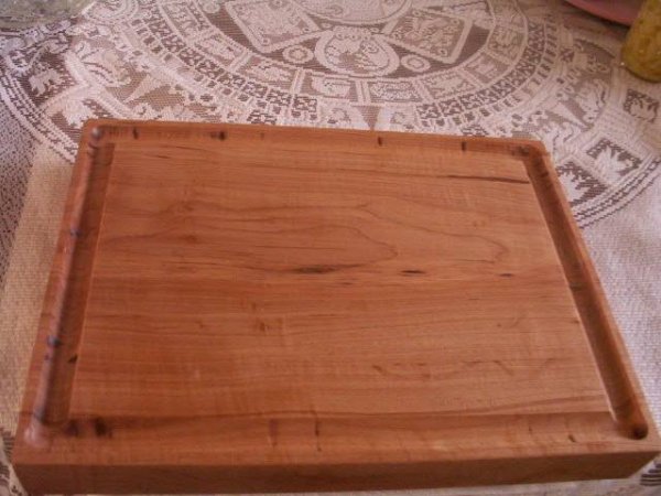

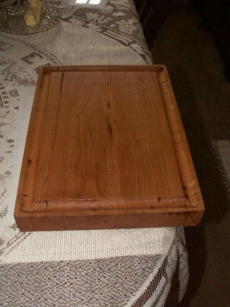

    Anymore I just use a single wide plank (9" to 12") of one wood that's 1.5 to 2" thick.Route a shallow groove inside the 4 edges a bit,sand & oil it with a food grade oil.Also turned a few round ones on lathe,that can sometimes limit your finished size depending on how big of swing your lathe has.If you normally turn larger bowls it wont be a problem however.
