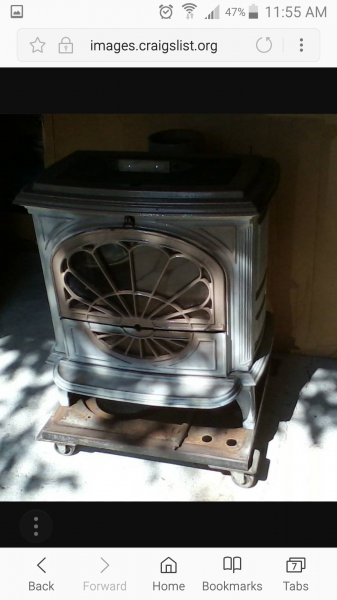

    Anyone know the model/specs on this Vermont Casting CS-45??? Still searching for a nice piece for the dining room.

    Looks like that would be a very nice looking stove for a dining room!

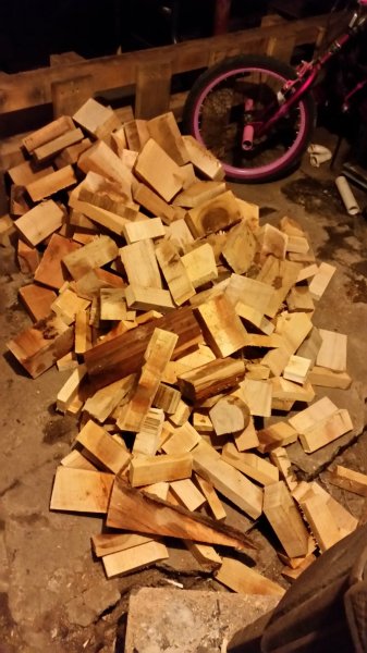

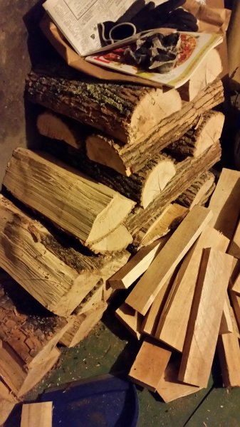

    Being laid off sucks, so I figured I would get out of the house and see if the neighbor had scraps before the snow storm. He did. Stuff that was frozen is leaned up against the wall to thaw. Couldn't fit it all in the picture.

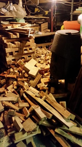

    Cranking Jotul now to heat the house and dry the wet stuff. I moved some of it away from the front of the stove for a walkway after taking pics.
