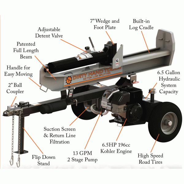

    There are two versions of the DHT 22 ton. The standard version & the BBS version. Lowes carried the BBS version which has a unique log catcher that has to be ordered and CANNOT use the 4-way splitter. The standard version has small wings on the wedge track that form a "log cradle" to help support the round while horizontal splitting, it uses the standard log catcher table (usually in stock), and can fit the 4-way wedge. The pictures on the Lowe's site for the 22T show a mix of the standard & BBS version, so I am not sure which they are selling now.
    DHT22T BBS version from Lowe's site
    DHT22T standard version (from the same item listing on the Lowe's site)
    The log extractors on the standard version are removable. This permits the installation of the 4-way head and the new extractors that come with the new head. There are also small wings on the splitter head track that form a small cradle for horizontal splitting. Two of the log catcher bolts attache to these wings. The BBS version log catcher attaches to the 4 holes in the I-Beam.
    The engine & hydraulics are the same on both splitters, just the standard versions offers a few more features and options than the BBS.
