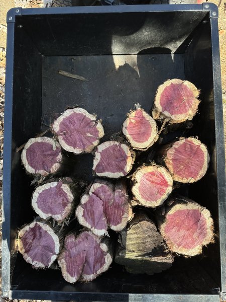

    So, this was yesterday:
    We have had what Eric Wanderweg would call a Dead n’ Down “cedar” (read: juniper) junking up the bottom woods since we moved in and yesterday was its date with destiny, that is, Mr. Stihl.

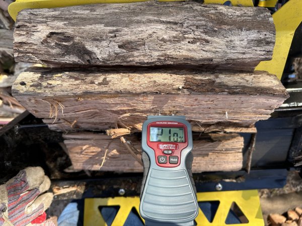

    Time to break out the brand spanking’ new MM. Instructions say the margin of error is 3%, so I’m calling every reading at +3 to be on the safe side. This will be nice wood to use judiciously.

    Eric Wanderweg gets a hat tip for excellent advice. We’ll wait a bit to burn this since it’s at a “adjusted” 20.5% moisture - plus you can see the outside is still damp. But it’ll be challenging. I’m really curious. Meh it’s too warm out anyways, especially for ash.

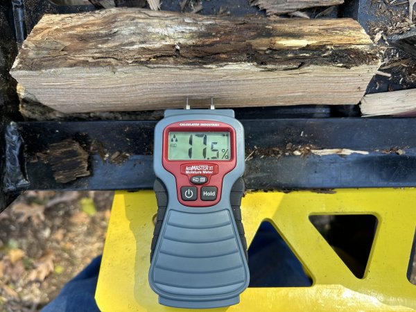

    The big surprise? This is red oak (pin, to be specific, I think). Mr. Cottonwood and I felled a few of them back on 10-08. I expected a higher reading on the MM.

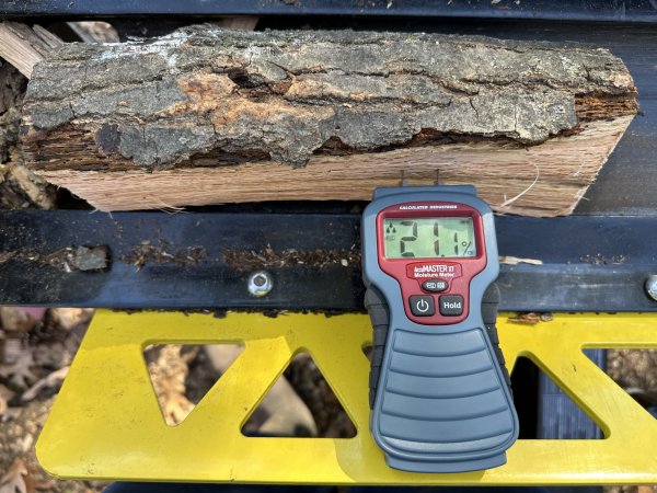

    This oak (I think) has been laying around since we bought the place. I was surprised it’s not drier.
    It’ll get there. Maybe it has a comparatively high reading because it was lying on the ground for all that time before we moved in.

    In my experience dead ash dries fast. Being on the cusp on dry, it shouldn’t take long. A month from now and it’ll be noticeably drier. You can also leave wood inside the room you’re burning in (not too close to the stove/insert) for a couple days prior to burning it. The fire will suck any remaining moisture right out of it.

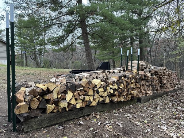

    Starting to look like an actual FHC house - except for the T-posts. I couldn’t talk The Wife out of them. IMG_0932.jpeg
    That’s the back of the pile - mulberry and oak. Some pretty small pieces there, but there’s a reason. We have a small insert, only 13” deep. And I wanna be like the grown-ups and load N-S. Means more work and small splits, but ok.

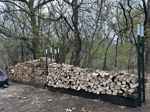

    The front of the stacks: IMG_0935.jpeg
    All the ash I cut is split. Time to go get more. Couple days before I’ll be able. It’ll be there.

    Nice inventory! Nothing wrong with t-posts, especially for the shorter splits. Trying to crib 13" splits wouldn't work out too hot once your pile got above a couple feet high. What you're doing will work out just fine (and be less effort too). Where I'm at it's too rocky for t-posts, hence the cribbed ends. If I don't crib then I use vertical pallets with 45 degree braces to stack up against, which works but looks wonky IMO. I'm digging your railroad tie/t-post setup :dex:

    Looks good from here. Wood should dry nicely.
    Good work.
