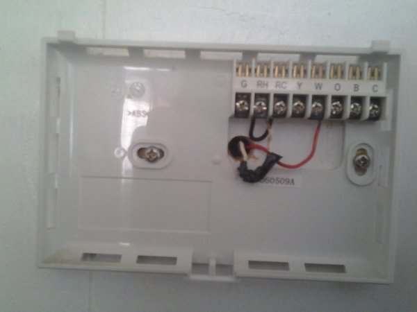

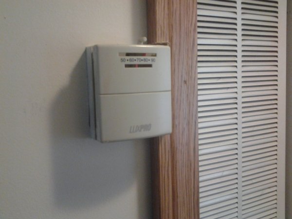

    This is what I currently have.......

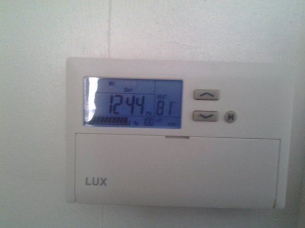

  3. Well Seasoned
    83,790
    Here is another for the central air where id like to hook up the 2nd tstat.

    Is it possible to "balance" your hydronic system so it would send greater volume to the bedrooms than to the LR?

    Do you mean closing off vents?
    As things stand now, the oil doesnt kick in at all, the LR stays warm from the stove, while the bathroom and bedroom cool down too much by the a.m.
    I think as of now, ill try and adjust the timing on the current tstat until I can figure out the right avenue.

    But that only makes it easier. Typically, the 6" branch runs have what is called a balancing damper in them. Close down the dampers to the t-stat area (loosen wing nut on damper handle, re-position damper, tighten wing nut). This will re-direct air to the far ends of the house. The balancing dampers can be found next to the trunk line normally. Don't close down the damper all the way though.
    When the furnace runs, it should direct more air to the bedrooms this way.

    Bocefus' option 3 sounds like a winner. Be careful running 2 thermostats on the same circuit. I actually killed on last year trying to do the same thing. You can add resistors in so the circuit can only run one direction, or use a switch which is what I ended up doing so only one thermostat works at a time.
    Also be careful closing off vents in the house. I've had 2 HVAC guys, one a good friend, tell me that shutting off too many vents will end up putting too much stress on your blower and end up burning it up. It's probably better to install an in-line fan for those longer runs.
