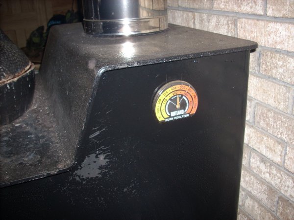

    I have a magnetic stove top thermometer...where should I place that on a Fisher Baby Bear? I have it on the angle between the low and high surfaces.

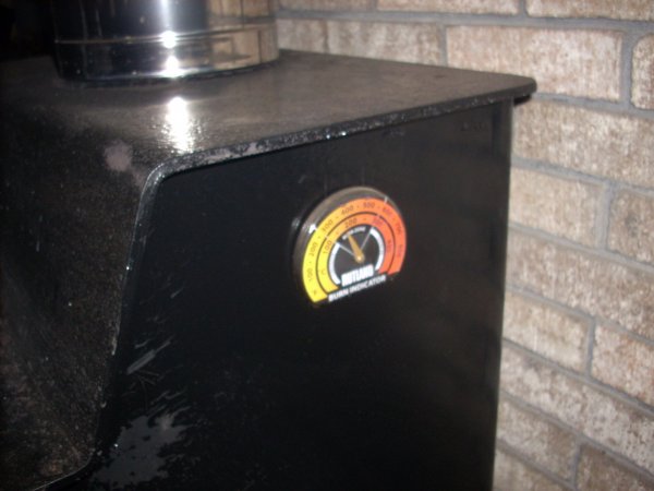

    So...My 'new' Baby Bear is doing a great job. I have the thermometer on the angle of the stepped top...what temperature range should I be looking for? Should I move the thermometer to another place on the stove?

  8. WeldrDave
    9,278
    48,415
    Right there! I've had it there for nearly 35 years and that has seemed from trial and error to be the best temp area for the Fishers! ;)

  9. WeldrDave
    9,278
    48,415
    Keep it in the "burn range" and you'll be fine! 300º to 550º is perfect for it.

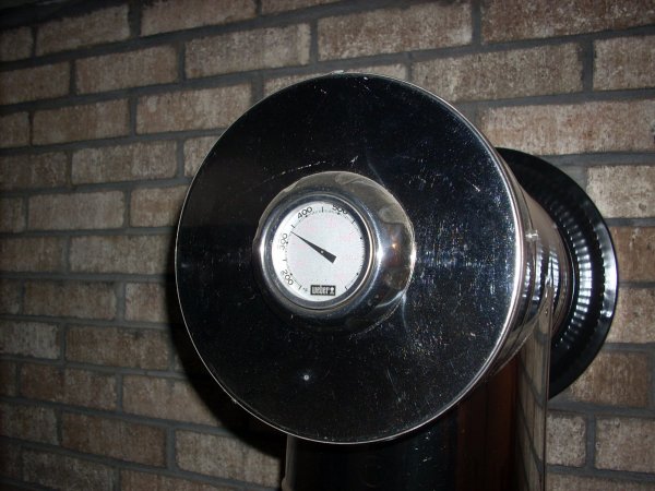

  12. WeldrDave
    9,278
    48,415
    Shack,
    I had to show you this when a Fisher is burning to it's full potential! This is what it should look like with stack temps and stove temps "with" a correct baffle! Best stove temps and cooler stack temps! This is telling you your getting the best burn for the buck! more heat in the stove and less going up the pipe! It took me "YEARS" to tweak this! The baffle is doing the work here so if you have better stove temps than pipe temps, your on the mark!!! :yes::dex::cool: It is 14º out now, 84º in the house and I'm getting 6hr burns on big Maple and Oak splits!
    Chvymn99 and shack like this.

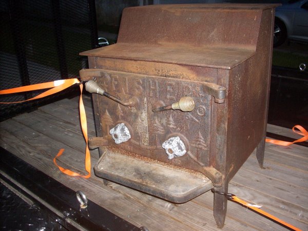

  18. WeldrDave
    9,278
    48,415
    Well, if you want to take a drive and have $400, this could be your's! :cool: I'll break even on this one between the purchase price, gas and the new fire brick I have for it!
    She needs a good cleaning up but it's in fine shape. I don't usually offer and I don't usually sell them but I'm going to thin the herd and as long as I know it's going to be used/cared for, I'll sell it! I'm in no hurry. If you want to map it out I'm in a town called Cape May, the very southern bottom of NJ.
    shack likes this.
