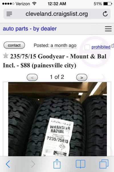

    I'm not buying these but I found them on CL. Not real close to me but I'd buy these if I needed tires. It includes mounting and balance.

    Rookie those are car tires, not a good idea to run on a pickup that is hauling or towing.

    A 235/75/15 is not a car tire..

    Rookie that's a decent deal! I hate wrangler radials ( I'm on my second set ) because they bulge after about a year but I must say aside from that the last a long time.

    235's are a light truck SUV tire....I tow all the time on those and haven't had an issue at all. As a matter of fact a lot of 1500 series trucks come with them stock now days.

    Ya know, I don't normally post info as fact if I don't know... Just saying!
    The P on the label in the pic means passenger car. A light truck truck will be an LT. Yes a P tire can go on a truck, but like I said, not a good idea for something towing or hauling.
    I did go to Sears tire college ya know... And yes I was present on lug nut day haha!

    It is a passenger and not a specific truck tire but it is designed for a truck. Most dont two trailer a with 12000 pounds of wood on them like you do. Maybe a lawnmower or a boat and trailer weighing less than 2000 pounds or a few thousand pounds of firewood. But you can't get that tire on too much of a truck as they dont get that big of sizes on them.
    Jeeps use wranglers stock as well.
    I remember when those tires were like $70 at walmart like 8 yrs ago. That still is a good price on them.
    I use to have them on my work s10 blazer and the smallest sticks use to puncture and rip the sidewalls. Seriously ones like 1/2" or less in diameter would open them up like a razor knife.

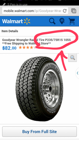

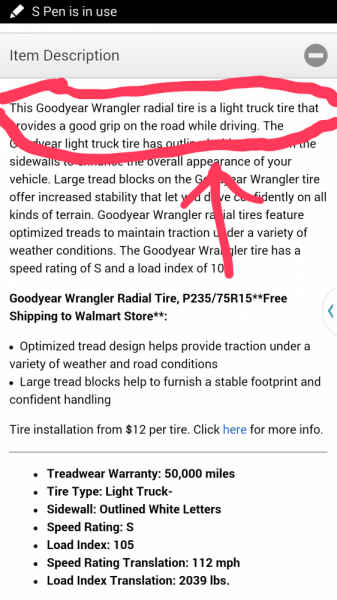

    This is the description. .
    Here is the tire in question. .
    And here is the description. .
    Also, with a 75% ratio, I don't think this tire would fit on many cars. Being about 29" tall.

    Exactly. I had a set on my Jeep when I first bought it. Dealer had put new tires on it.
    Somehow they survived the ALCAN fine, but the FIRST trip out on a "trail" i rubbed against some branches and i ended up with 3" branch blowing through the paper thin sidewall.
    Run whatever you want but I'd be looking for at least a C or D (6 and 8 ply) tire. P tires are 4 ply at best.

    Dex no one is saying that the tire is not for a truck specifically. But it is not a "truck tire" in tire definition terms. Those all start with LT as there stiffer and hold more. Most trucks now a days and suv's are basically passenger vehicles and tires for them are usually designed to give that ride.
    That size tire fit all the old school full size w vehicles up though the 90s.
    I too spent a few years selling tires in a national chain professional tire retailer.
    I do not argue the fact though that 99.9% of those tires will be put on a truck/suv. The remaining may end up on old cars bit more likely trailers which should have ST tires on them. Some run LT on trailers which is basically ok too. And even what I am saying I run P tires on my trailers!!!
