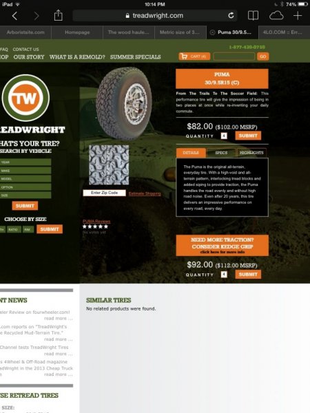

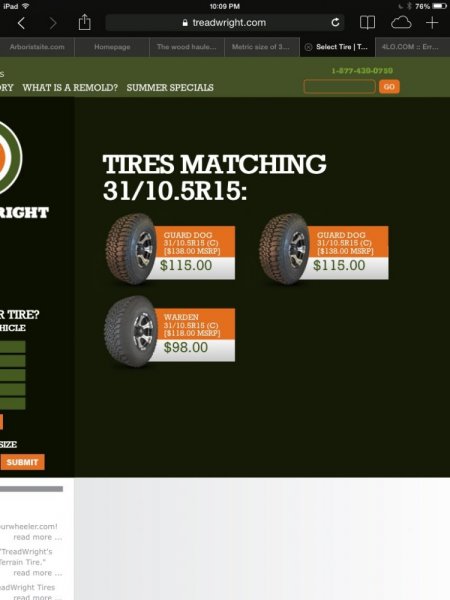

    Here are tires in the same size. Wardens are under $400 for four tires (before shipping)
    And then these are 1" narrower and 1" shorter.. These are under $330 (before ship)
