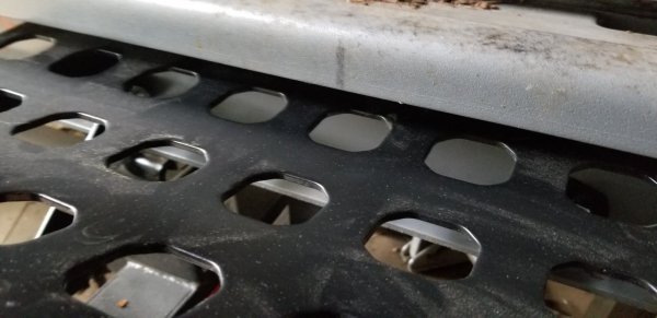

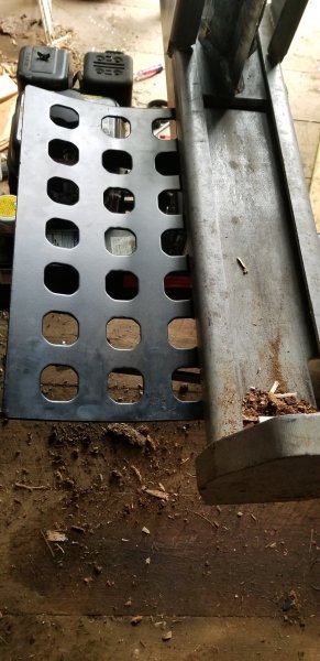

    A little bit under the beam, but I will be happy with it. It beats dropping the half-split round and picking it up again.
  4. T.Jeff Veal
    29,780
    191,291
    That will be a big help...

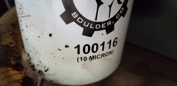

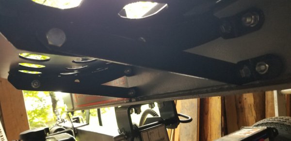

    After 2 1/2 days of rain, I decided to get the shelf installed. Two easy holes and I just have to locate my metric impact set.
    Also replaced the hydraulic fluid. The filter is NLA and I haven't found the equivalent cross reference yet. The filter that came with the machine is DHT branded with their part # on it. I just want a good brand name from a local store and not from Amazon.

    My DHT 35Ton takes a NAPA gold 1551 Hyd filter that is a cross reference to the original DHT. A quick check on the DHT manual seems to indicate the same filter for 25 and 35 ton splitters. The NAPA 1551 is easily cross referenced to many filters (Fram, Baldwin, Fleetguard etc.).

    I did see that number on a net search. I think the microns was 15 for those bigger models. Mine is a 10 micron with a 15 gpm pump. There is a Napa not far from work, I'll have to grab one and thank you for checking.

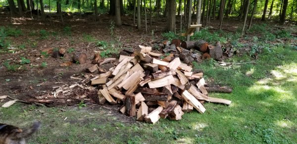

    Dry air moved in with a good breeze this afternoon. I spent a little time working the cherry pile. The splitter worked fine with the changed fluids. Everything was just soaked and covered in dirt from the rain splashing. I can't wait to get at the EAB ash out back, but I have to process what is on the ground first.
    I took Holly out for a good ride to a local farm to get some eggs and check out the horses. No complaints from her.
