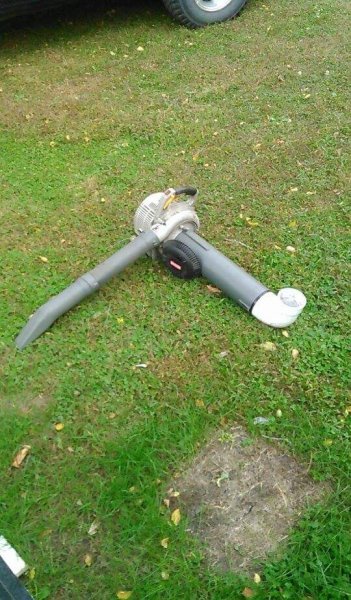

    I got this little do dad rigged up today too works pretty good!

    You being in a tight neighborhood might have a problem with the leaf blower trick. If a neighbor sees that gosh awful black cloud, they just might call the fire dept. It is is windy and the the soot drifts over to a neighbor, they might get irritated.
    I don't like the soot getting all over every thing and me, so I tried running it with a leaf bag on it. works really well. cuts the black cloud way down. another thing is to run it after dark when no one can see the black cloud. I also have a remote start I plug into. That way I can stand way back when I turn the blower on. Don't even want to be breathing in any of that crap. I turn it on off a few times for only a couple minutes and I'm done.

    The LBT is a great tool for a stove.
    Nice set up Pete!!
    The best way to get the most suction through the stove, is of you plug the top of the flue. This will help to unclog anything that is trapped in areas you can't get..
