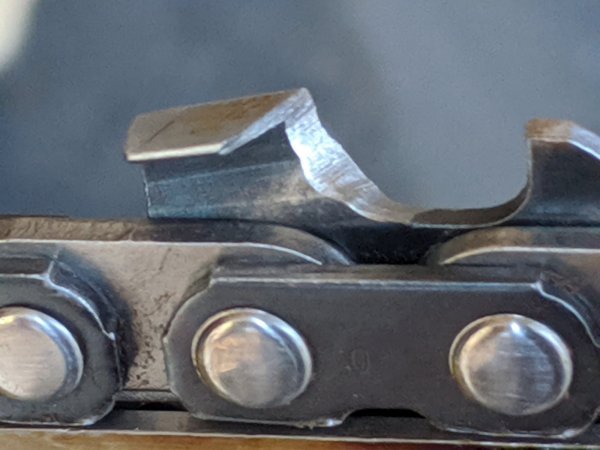

    Have to admit I have tough time it comes to sharpening chains. That is why I picked up the Stihl 2n1. It has helped me with the angle if nothing else. Some people knocked it for filing the rakers every time, but I have confirmed with a sharpie that it doesn't hit the rakers unless they are to high. Still not sure my angle is 100%, I feel like there should be more point.
