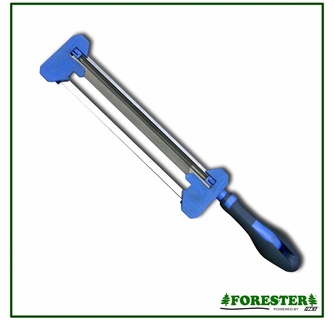

    Stihl dealer had them for 40.00 i bought a 3/8 works ok
    But much like the forester all in one they are to bulky and cumbersome for me maybe it's because i'm left handed lol.
    I always unlock the foresters file holder trying to use it.
    And let my friends have them
    I always free hand file anyway.
    But i'm brought badly rocked or sharpened chains all the time
    I use the husky roller guide to get the angle back
    Then i hand file after that.
    14.08 from Forester for the all in one
    The Stihl/pferd work just not for me lol forester-all-in-one-chainsaw-file-guide-9.jpg
