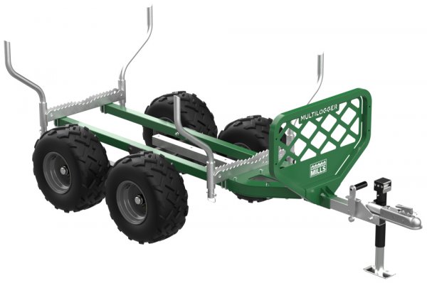

    I've seen those before pulled by horses. Thankfully most of what I will be winching is not over long distances so I'm not really concerned with dirt and debris on the logs. I mainly just need to winch the logs to a spot where I can pick them up with the grapple. If I could go back about 15 years, I would have purchased something like the trailer below to make life easier.

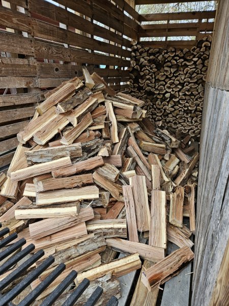

    If that wood was standing dead a couple years and then cut, you have no problems CSS into the shed you have now. We have 2 sheds very similar to yours.
    This shed is 14' long, open on both ends, pallet walls. The white oak, blew down in Sept '24, we CSS Feb '25, loose stacked and ran a fan on it some. It went to friends a couple months ago, they said it burned fine... 20250304_185326.jpg

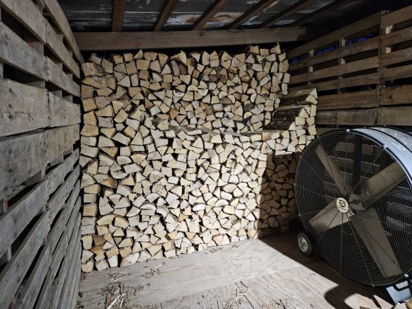

    This shed is 15' deep with slat floor, sides and end. 8' walls. White stacked in Jan '24. We burned a bit of this as well, it burned great, never saw any water coming out of the ends.
    Stack loose like you have the other, and make it easy on yourself, especially if you're not going to use it for 2 years. 20250131_103536.jpg

    Even better, free drying. You would be surprised at how much air will still go through the stacks. We've had 4 stacks deep in the shed, with fan on and walk past the back of the stack and feel cool air coming through.

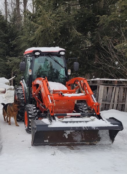

    Regarding the digging out portion, I do have a slight advantage here, and there won't be any shoveling going on...

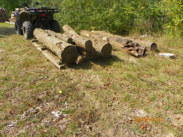

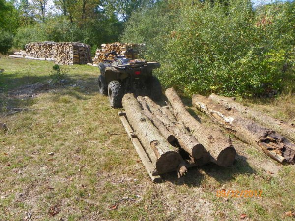

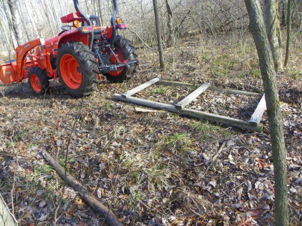

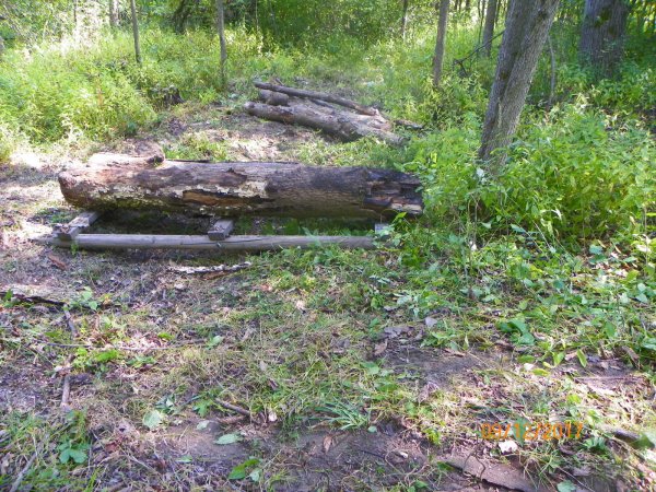

    No need of paying big dollars for something that is easy to make for very little cost. I built my last one for less than $20 and probably less than $10 because I used stuff I had on hand. When I got into logging back in the 50's this is how we skidded logs (you can make one to the size you need).

    An old set of skis which are free so the tips go up and over brush and sticks works great! Last set were screwed on with electric fence insulators
