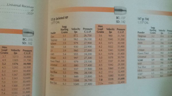

  11. bocefus78
    bocefus78
    Oct 14, 2013
    3,694
    19,840
    Indiana
    This is from a lymans manual
  12. clemsonfor
    clemsonfor
    15,996
    37,478
    Greenwood county SC
    That has to be load data for the 9mm not 380. I see it says start with 3.8 of titegroup with 115 bullet. Thats blow your gun up territory in a 380.
    NortheastAl likes this.
  13. bocefus78
    bocefus78
    Oct 14, 2013
    3,694
    19,840
    Indiana
    Yes it is. I didn't see that he said for 380 or 9mm. He said 115gr so I assumed 9mm. Op my lymans does not have data for titegroup in 380 on anything heavier than 95gr.
