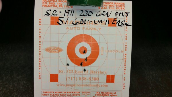

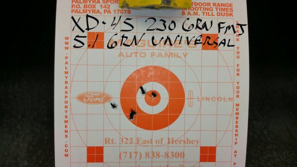

    Here are my results from my first reloads of my life...

    Good feeling isn't it? BTW, Universal is one of my favorite powders. Great medium burn rate, meters great, and very cartridge flexible.

    I'm just happy they functioned

    How do they compare to factory ammo for accuracy in your guns? I've usually had an easy time equaling or besting factory ammo unless I'm going off the rez with either "moar powar" loads, or powder puff loads.

    As this was the first batch I used hodgdon's lowest charge @5.1 grain. Recoil was much lighter and the accuracy was the same maybe a touch better. I think I'm going to go to half way between lowest and full charge and see what I get ....

    Do yourself a favor, and play around with a few different charges to see what you come up with. Different firearms seem to like different loads (even same model firearm, different person) and maybe you're just .3 grain of powder away from magic.:D

    Shoot from a rest so you can track accuracy without shooter error.
    I loaded plated to mid level jacketed range. I don't shoot plain lead so no comment on size but I've read .001 oversized is better than under.
    I agree on loading up more in .1gr increments. Don't jump to half way...you may skip "the load" and never know it.
    If the cases were really sooty that's a sign of being underpressure (low on powder) and the brass not sealing in the chamber as tight. It's not all bad, but for uspsa don't u have to make power factor?
