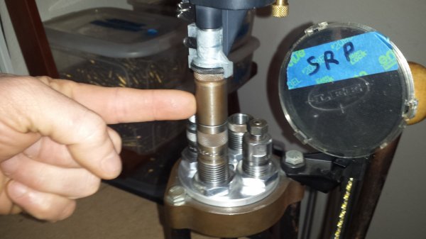

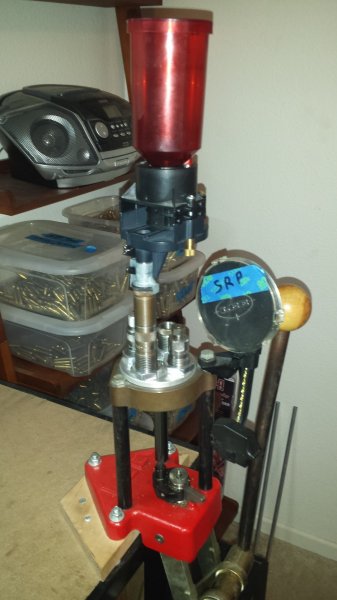

    ^yep...I forgot about the powder hopper riser!
    You will also need a primer flip tray. Forgot that also.
    The kit comes with the priming system, if you get the bare press, you will also need that separately or buy a hand primer. I like priming on the press but it's personal preference.
    Pic of riser attached
    Priming system is the round plastic thingy
    Fwiw, lee dies come with a shell holder and a scoop for powder so those items aren't necessary
    Other pic shows it all together

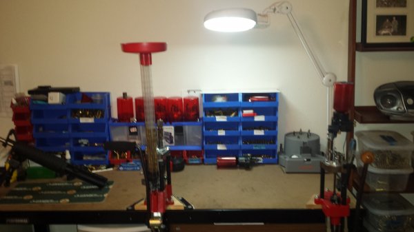

    And before you know it, presses have babies. (This is an addiction, not a hobby)
    Lol
