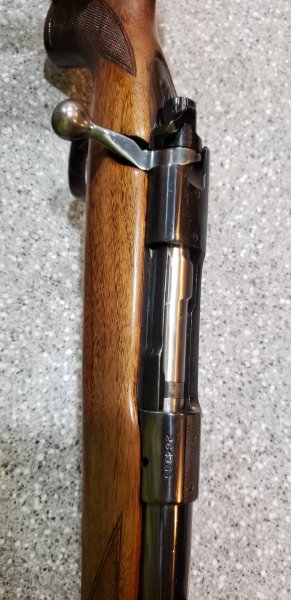

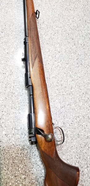

    Well I finally got my Winchester model 70 pre-64 back from the gunsmith. He was able to correct the issue of the bolt dragging. As I believe what I said before someone before me tried to glass bed it and used a punch to beat on the feed rails to get the gun out of the stock and messed it all up. The gunsmith used honing stones to take out the high spots out of the feed rails and now it is as smooth as butter.
    Here are some long awaited pictures. I haven't had any time to shoot it yet. Rhe gun is in beautiful shape as you can see!
    I have a few more pictures to follow.

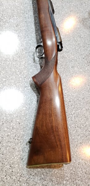

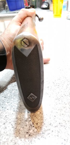

    Here are the rest.

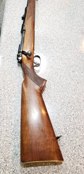

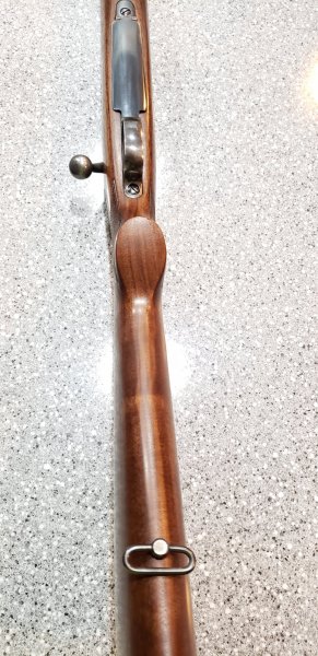

    And the last 4 pictures. The gun overall is perfect except for some light finish wear (no dings scratches on the wood or metal) on the stock and some bluig wear on the bolt and floor plate. The only thing that's going this gun is a leather sling!
