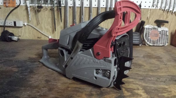

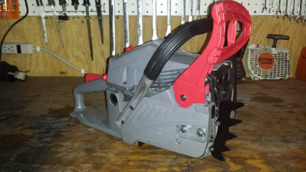

    This ones been completely stripped twice. Once when I did some port work on the 45cc engine, and the second when I pulled the 45cc engine and put the 58cc engine.
    The tank and plastic are the only thing that is "Earthquake" on this one ;)

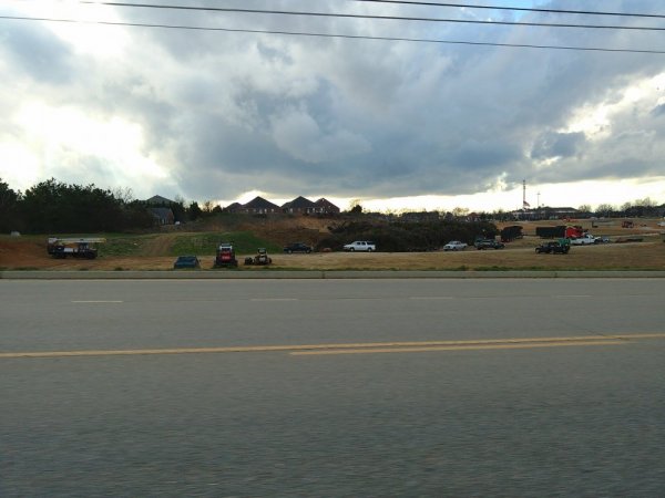

    IMG_20140303_164141_409.jpg Yep. Did you watch the news a few weeks ago. The had a major ice storm below me. There is trees down everywhere. Not a saw was to be bought a few weeks ago in the box stores. The big stihl store sold 600 saws that friday saturday and like monday or something till they sold them all. The store I go too hardly had any left.
    I had my extra 45 listed and never sold. After the ice I listed it and had 4 people in 10mins . No one has talked me down yet. First one got $100 second d I wanted 120 but still had 100 in my text and 120 in the hrading. So I said how about $110 and the guy said ok.
    There is another guy that said he wants 2 for his landscape biz. And verbally agreed on price.
    Augusta GA , home of the masters is in overdrive to clean up themess before the tourney!! Here is a pic of the junk at ONE of the staging areas. This pile is as big as a highschool gym.

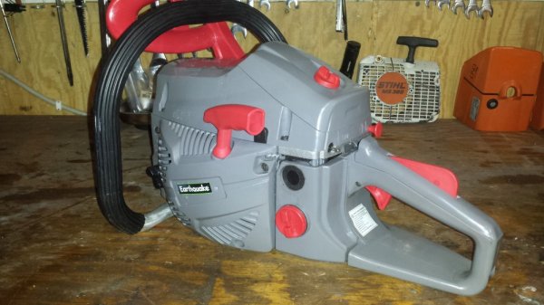

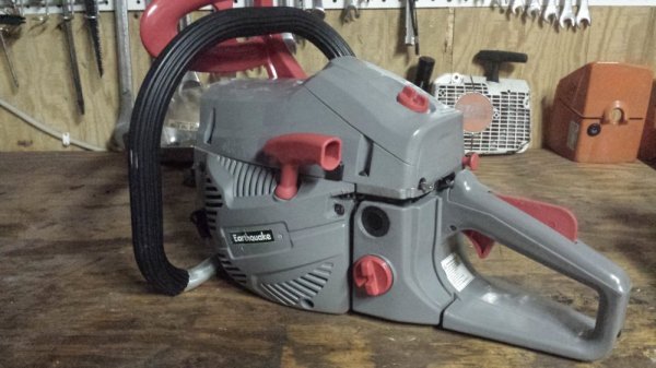

    My 45 cc ;) Earthquake got some treatment today... Some sticker treatment. :) Or some Sticker removal I should say.
    Flash and no flash pics.
