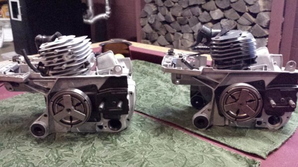

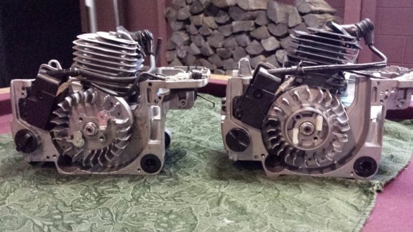

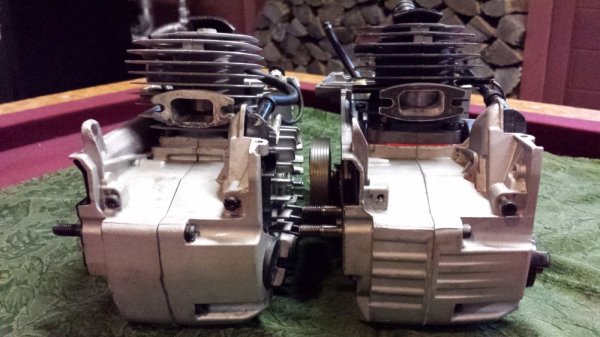

    I ended up just ripping the actual rubber A/V mounts out and that left bough room to wiggle the tank free. After that, I started assembly. . . . It's now finished.
    Once my daughter wakes up, I will take it outside and start it up. :thumbs:
    Here are the differences in the cases... (almost none). The very front of the 58cc machine has little slots cut into case (looks like a Husqvara) and the 45cc is smooth (like Stihl) other than those subtle differences, they are almost identical. Definitely different, but are alike enough to have no problems lining up pieces/parts. :thumbs:

    I agree you should not have to weld on it butit stripped so some other method was nneed ed. You also should not need to rid the rubber out either. These are not quality machines.

    Looks a good bit larger. More than just the cylinder.

    31,637
    Northeast Oh
    Nope. Same size. Everything. The pics may look bigger or smaller, but they are not. All plastic mounts up as if it were on the other case.

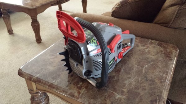

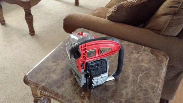

    Here are some pics of the new and improved 58cc Earthquake! ! :) With a single Big Dawg on the front :thumbs:

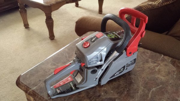

    And on the wifes coffee table too! Nice dog.
    You can tell thats a clean new one the "as is " ones are pretty oily.
