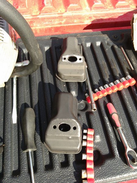

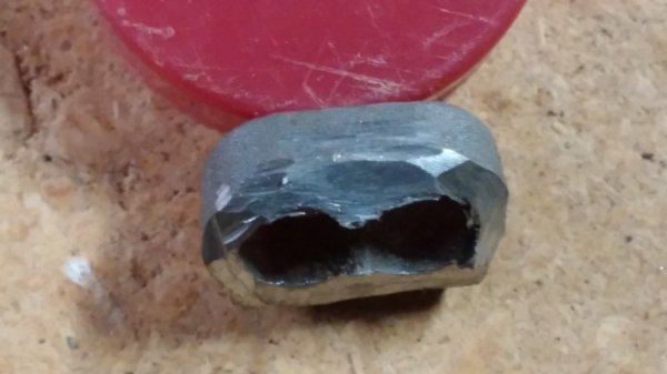

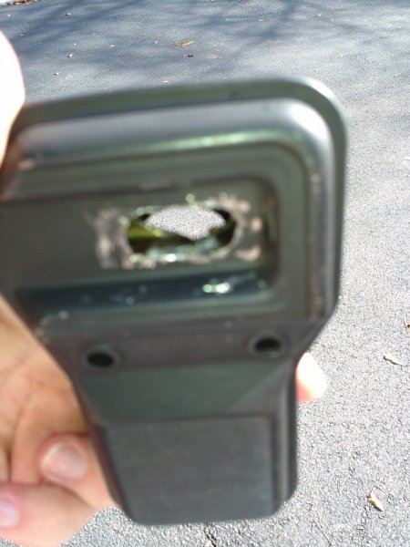

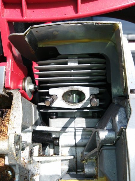

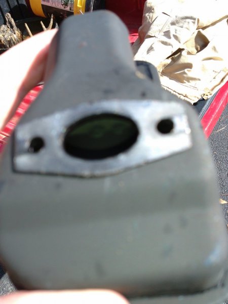

    Ok I got my Rex Max gz4000 regular muffler to replace the one on my 3814. I took it and cut the front out and then drilled out the baffle. This is a hack job as I did not have much time. I will clean it up latter.
    Seems a bit more responsive. Maybe revs a bit higher yet still and is louder.
    The pictures are of the 2 mufflers. Then inside the factory one , you can barely see the catalyst housing in there. Then a picture right through from front to back of my modded one. Exhaust goes in then up IMG_20140207_112114_187.jpg IMG_20140207_112152_149.jpg IMG_20140207_112212_358.jpg IMG_20140207_112235_828.jpg IMG_20140207_112202_736.jpg and out now. I'm going to grind the inner lips back more and clean it up but its good for now. And a pic of the tiny hole I put in tha new muffler that I will have to patch. Wheremy drill bit hit the back and pierced it a bit. And a shot of the piston just cause I was there. No scratches or any wear on it. I have a tank or so of fuel through it. At this point.

    here is my 3814 with the Red Max gz4000/ryobi non cat muffler. I did a mufflermmid and drilled the barrel out and opened up the front outlet 3x the factory size. I have not cut the deck sector out much as it was already pretty large .
    He is a video of it cutting. Compared to my stock video it looks like its 33% faster in the cut. Time went from about 36 seconds to 24 seconds with just this mod.

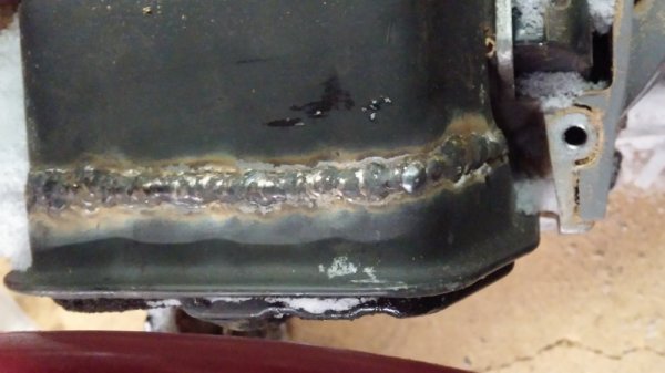

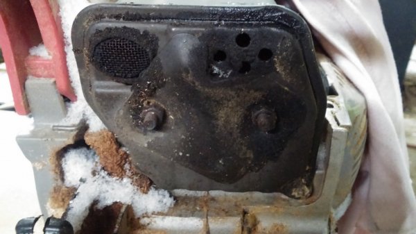

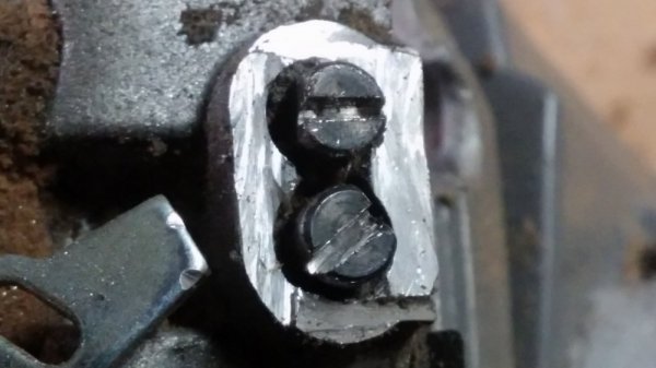

    Some pics of the carb and muffler mods on my 4518 0215142012.jpg 0215142017.jpg 0215142017a.jpg 0215142018.jpg

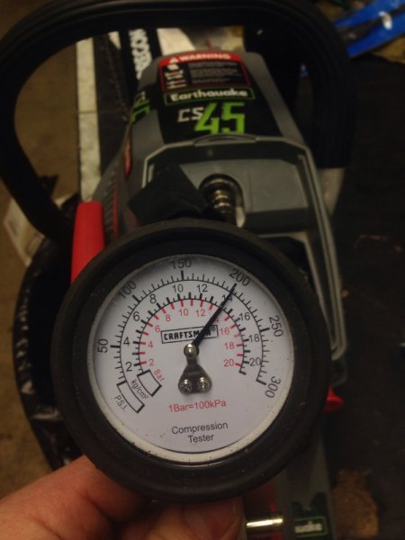

    Wow wish I had a pressure tester! AC and I gutted the muffler welded it back together and added about 100% opening to the front and that saw cuts! I'm in the process of doing the other one now. If I open the port how much is reasonable to remove from the port or is simply sanding the port a better idea?
