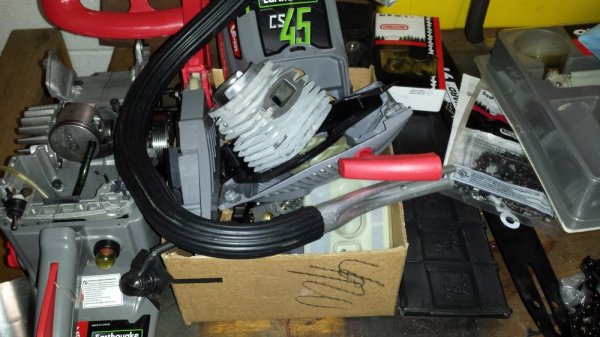

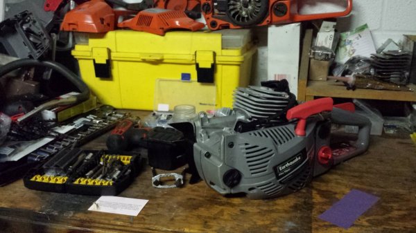

    K.. My 45cc did look like this a couple hrs ago.
    In a box :(
    But she is almost back together. :)
    Did a few little things. I am no builder. I am a pretty good mechanic and have worked on everything I own, but I do not claim to be an engine porter/builder.
    I took some weight of the _____. Then I opened up the ________. Widened the _____. Took off the ____ _______. Ground off some of the _______. And that's about it ;)

    I didn't mess with port timing. Only widened the intake and exhaust. Opened the transfers a little and opened the windows a little. Shaved a considerable amount of weight off the piston itself. Ditched bade gasket (squish is at .035) and I am about to start it now :)
    Just got done with it. I have been messing with so many other saws. And finally today after grinding on the 55 Rancher. I decided to just do the Earthquake.

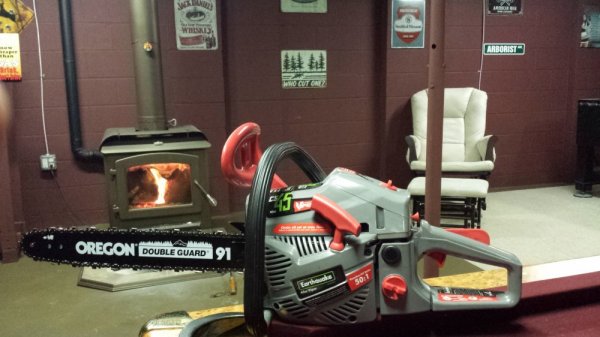

    Back on track. That Earthquake started an ran like a beast. Will be putting it in wood tomorrow, then letting it cool and testing compression.
