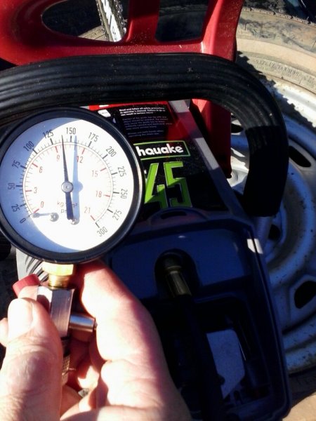

    Finally got a chance to test compression on my personal 4518. Not what I washopeing. Looks like its time to saybyebye to base gasket.TThis saw has zero time in wood. No dust anywhere. I'm sure it was started but this is the saw where the chain brake was binding the clutch drum, which I'm 99% certain that is why it was returned. I have one tank plus through it. Piston looks brand new no scratches. I am running husky semi syn oil mixed @32:1 that was added to a jug with about a pint of woodland pro syn oil mixed @50:1.
    I'm sure rings are not seated yet but was hopeing for better than 145psi!
