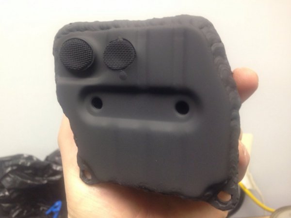

    How big are you guys making the muffler outlet??

    Decided to do the muffler mod

    I don't know where you are at currently Mike, but I ditched the whole cat assembly, tack welded the supports to the reinforcement plate, and re-assembled. Also added the 2nd port.

    Here is everything that was inside
    I cut the end off the square support baffle, it originally had a hole the same size that you see on the end.
    I think I will put it back together like this. But will need to weld/braze the internal pieces together. Just got to decide how big to make the outlet.

    Good minds think alike... Just what I was planning to do.
    Got any pics of the second port???
    I was thinking of cutting out the existing pipe and putting in a bigger piece.

    I also ditched the box entirely, and shortened the outlet pipes.
