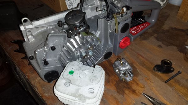

  10. DexterDay
    DexterDay Administrator
    12,411
    31,637
    Northeast Oh
    This is a recommended chain from another place on the net.
    Oregon 91VXL62
    This should help a lot, along with a Muff mod, and a good tune (11,000 seems pretty conservative.) These come very fat from the factory.
    As for the 023/230 comparison. This Quake is built like a pro saw (split case as Mike from Maine described above). Much easier to work on and they seem to respond well to mods.
    Not a lot to the cylinder. The ports/transfers are of the simplest design. More pics later. :)
    the GOAT and raybonz like this.
