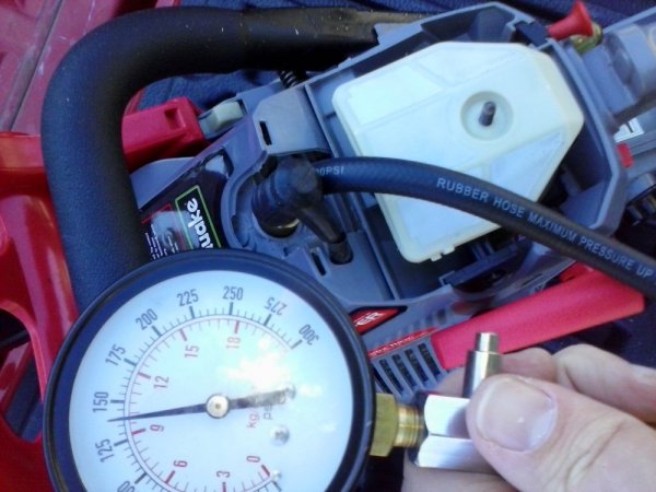

    Anybody tested the compression on their 38cc? Mine only blew 135. Maybe I don't have a good seal? Gonna wet the boring and try again.
    Retried it with moistened ring. And as tight as I can finger tighten. And got 145. IMG_20131212_102548.jpg
  15. MasterMech
    9,648
    26,048
    Greenville County SC
    Make sure it's not blowing the oring off to the side, breaking the seal. My CS3814 blows 165psi.
  16. clemsonfor
    clemsonfor
    15,996
    37,478
    Greenwood county SC
    It looked sealed even around the opening? I did not pull it with plug right after to see if it felt the same?
    Now the 4518 has more of a pop pop on the cord, definite compression difference or just the saw and recoil assembly.Not tested it yet.
  17. DexterDay
    DexterDay Administrator
    12,411
    31,637
    Northeast Oh
    What is your fuel mixed at? Was the saw cold or warm?
  18. clemsonfor
    clemsonfor
    15,996
    37,478
    Greenwood county SC
    Thought about that Dex. This saw was cold outside temp was in the 40s and it had not been run since yesterday.
    Fuel is baileys syn mixed @50:1. Thought that warm and fuel mixed 40:1 and a more broken in saw it should increase.
  19. DexterDay
    12,411
    31,637
    Northeast Oh
    Warm saw will give you lower #'s. Cold saw will yield higher numbers.
    Mix some 32:1, retune, Run a full tank through it, and then wrap a few layers of pipe tape around the threads of the tester (just to be sure of a positive seal).
  20. clemsonfor
    clemsonfor
    15,996
    37,478
    Greenwood county SC
    Oh forgot u said warm saw will lower, seems opposite to me?
    I don't have a double D tool just a single.So I will have to pull the Carb and cut slots in screws. I will muffler mods it at the same time so I only have to tune it once . Not sure when I can get to that. The baby and helping moma takes most of my time now :)
