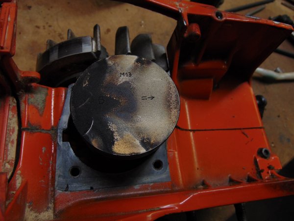

    Shawn, Eric noticed a bunch of gummy carbon on my 346 upon teardown. I told him it'd been sipping R50 for a while @ 40/1. On another saw forum there's been a discussion about echo red armor and how well it cleans deposits. I plan to run a tank or so of it every once in a while to help.
    Here's a pic showing my 394 which has been doing a lot of milling w/ husky xp oil @ 32/1. Hate the smell of it though. I need a respirator. :dennis:

    I have seen simular gunk from stihl ultra myself. When I got my Dolmar I got some Dolmar synthetic 50:1 with it. It burns very clean and leaves a nice film on the exhaust side of the piston. (I haven't done a full tear down just to inspect the oil)

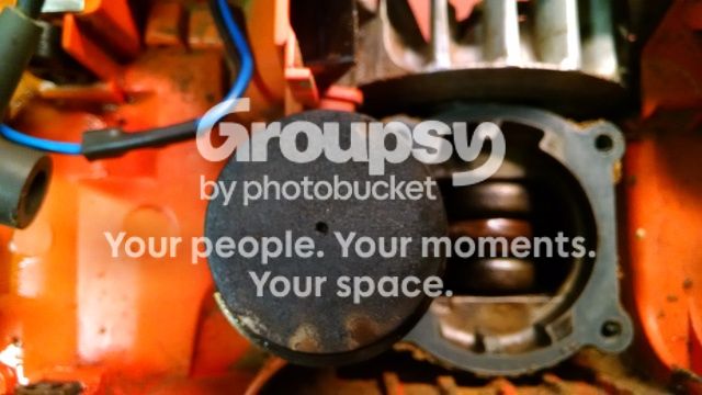

    A pic of the piston out of my '98 350 with God only knows how many hours on it. It had a layer of carbon, but just a thin layer. That piston went back into my rebuild and is still running great. Husky & Echo brand mix with maybe a little Stihl in there also. 50:1. There was very little if any buildup in the muffler.

    That looks good to me.
