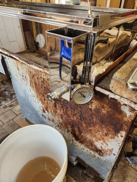

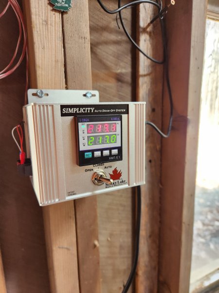

    Coming off at a different temp than the other day. Gotta love it !

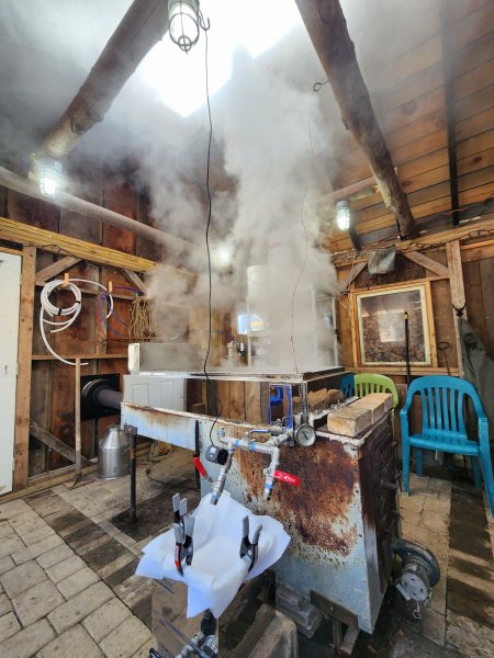

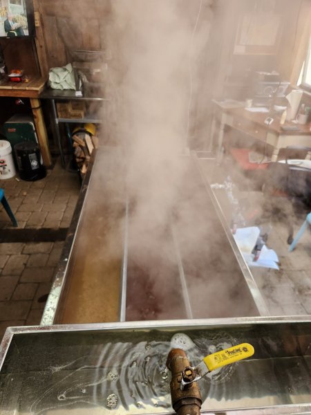

    That’s always fascinated me as well. We evaporate outside and then finish the last gallon or so inside. Boil it to 217 and then bottle it. Sap going in at the top of the evaporator and then meeting the requirements for sap as it flows out the other end is nuts! How much fine tuning do you have to do to get it there or is the evaporator designed to essentially manage itself?
    Softwood and HoneyFuzz like this.
  9. HoneyFuzz
    HoneyFuzz
    Jan 20, 2014
    4,490
    14,863
    Northeast , Ohio

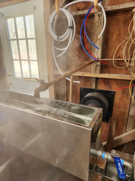

    I'm glad I'm not the only one !

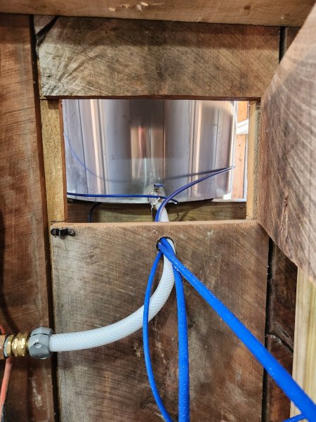

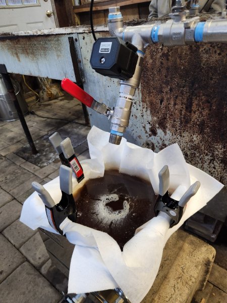

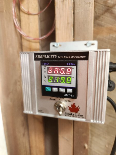

    Not much fine tuning on this pan. Just mostly maintaining my 1.5" sap depth..which I do with a manual valve....with RO concentrate gravity flowing in. And make it flow at a higher rate as I draw off. That's abt it. Just kind of waiting for a problem...filling the fire box every 9 minutes...and catching up on Walker Texas Ranger !
    20240223_135616.jpg 20240223_135612.jpg 20240223_135602.jpg 20240223_135557.jpg
    The pan just flows amd does its thing. 1st season..I was on edge ..now..id have to pass out for awile to even begin to have a problem lol !
    Im able to draw off finished syrup on this rig....but I usually make it come out alil on the high sugar side..then fine tune/dilute it to the right amount on my finisher/bottler. Easier to control things.
    Most of the work..as you know...is all the prep work before..and after season ;)

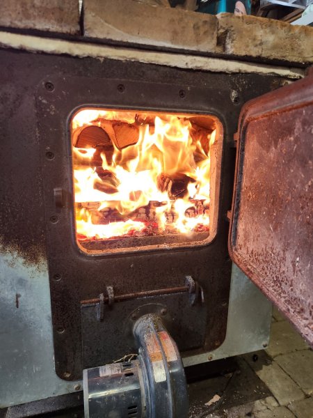

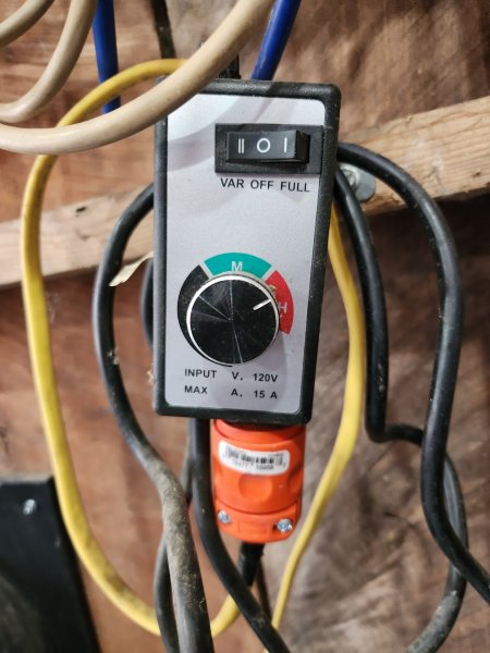

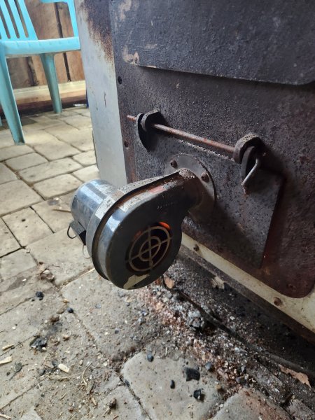

    HoneyFuzz Is the AUF (air under fire) always running when you're not stoking the fire?
    HoneyFuzz likes this.
  11. HoneyFuzz
    HoneyFuzz
    Jan 20, 2014
    4,490
    14,863
    Northeast , Ohio
    The minute the fire gets roaring good on first fire..the blower goes on..and I don't shut it off till I'm winding down for the day .
    I've got it on a variable switch from Harbor Freight. 6 years..no problems ! Running it all the way up .... ends up blowing ashes out of the gaps in the door. This switch cured that.
    The blower by itself...significantly changed our boil rate for the better. Made a big difference.

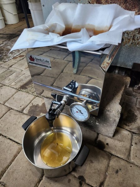

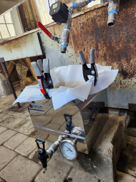

    Sometimes..on a good day..(today).I fill up the filter/bottler. Them I have relieve some into a random clean pot lol !

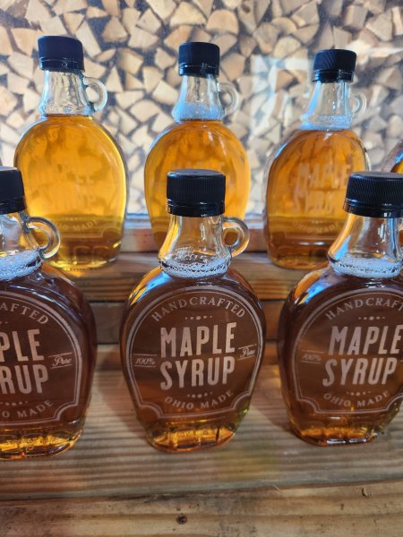

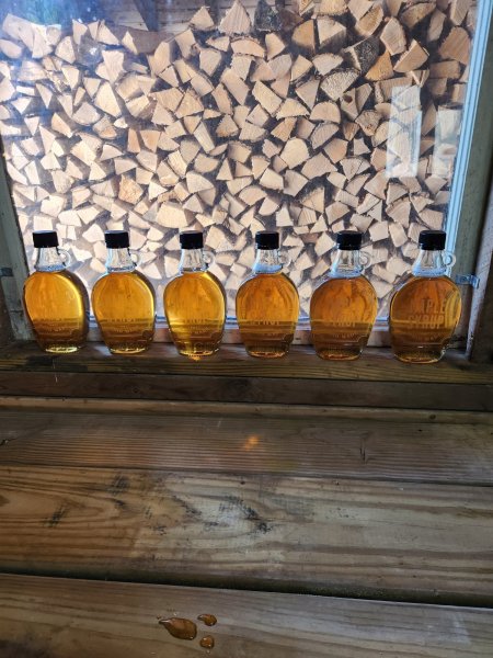

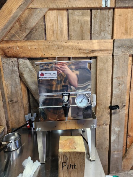

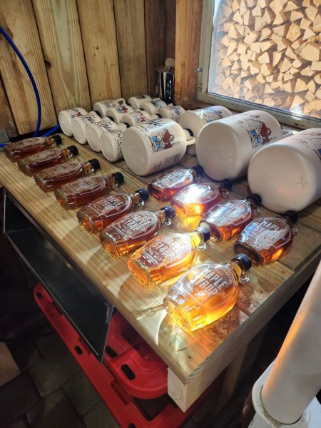

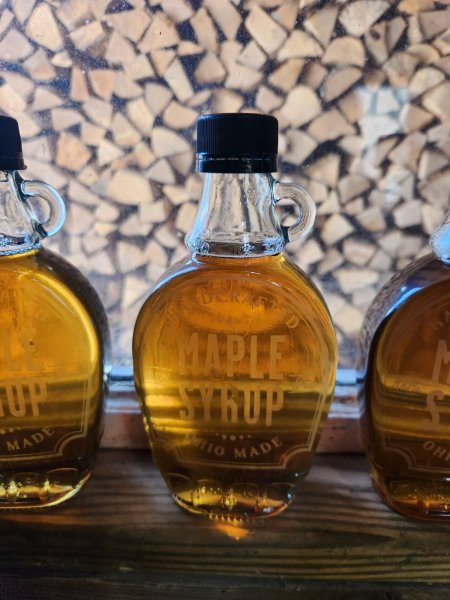

    Got some bottling done today..about 5 gallons or so. Trying out some new glass bottles..along with the usual plastic.
    Also used the permeate water to rinse out all buckets..tanks..and pan.
    Pan also got a light scrub down..and rotated around. Cleaned firebox..swept floors. Had to find a way to hang up auto draw off out of the way to rotate pans. Some scrap electric wire does the trick lol ! Brought bottler...hydrometer and murphy cup...orlon filters etc..home to wash with hot water. Ready for hopefully another week or 2. These warm days need to slow down 20240224_114933.jpg 20240224_113448.jpg 20240224_105351.jpg 20240224_105258.jpg 20240224_105301.jpg 20240224_105238.jpg 20240224_105236.jpg 20240224_103609.jpg 20240224_100906.jpg 20240224_100902.jpg 20240224_100251.jpg 20240224_100243.jpg 20240224_091514.jpg
    All came off Amber Rich color. I've actually never made light. Not by choice either. Just never happens
