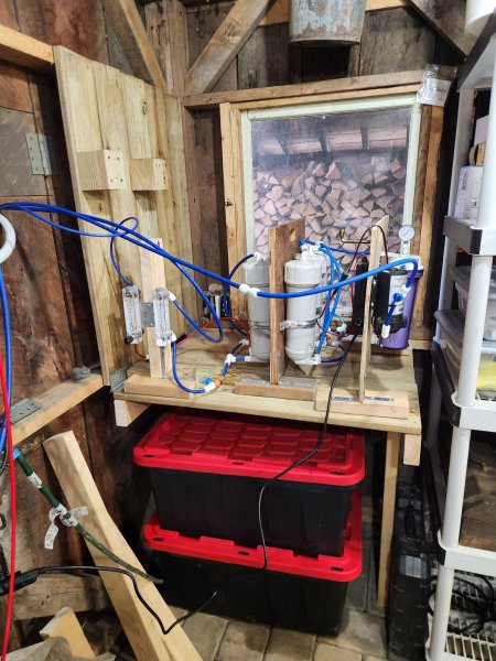

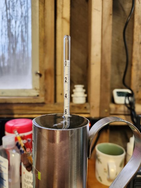

    After some pains this morning..got the rearranged RO up n running. I've upgraded over the years to where I'm at now. Its all RO Bucket. Now it's a 5 membrane setup . Now I have split it into 3 boards..so the weight and awkwardness isn't so bad on my old body lol. These flow meters are so much better at dialing in than the old needle valve. I'd be lost without the RO ! Went from 2.5% to 6% one pass. Gonna tweak it a tad to do a little better ;)

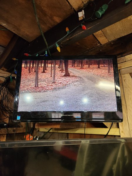

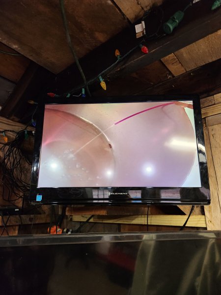

    Sap Concentrate /driveway cam

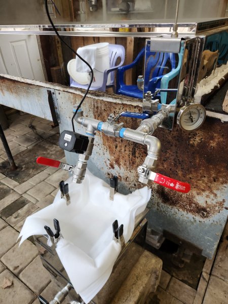

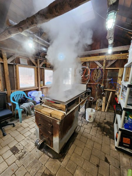

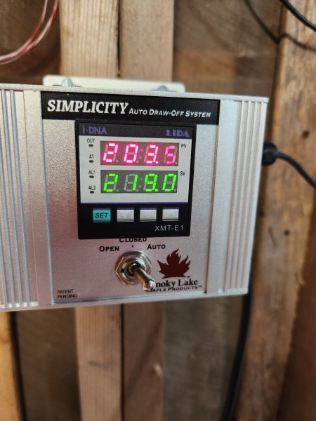

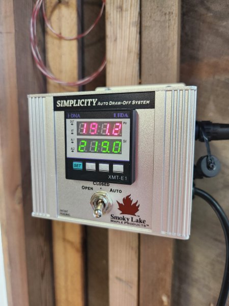

    Up and going. First year with an auto draw off. Very excited and nervous.

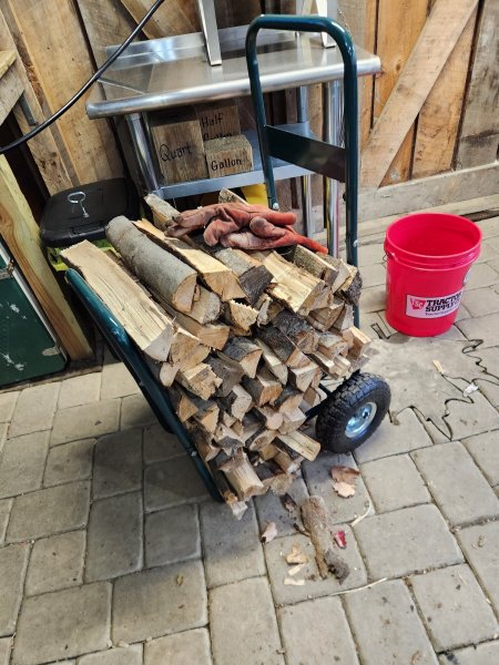

    First year with new wood cart. Loving this thing ! The little things can make a big difference @

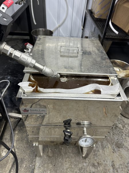

    We had a good day. Ended up with 13 gallons. IMG_0621.jpeg A couple big draws at the end of the boil topped off the bottler.

    I'd say that was a great day !!!
    I see we have the same Smoky Lake bottler / filter. Love that thing!

    It does a great job. We started using a r o this year and the gravity filter just don’t keep up. I’m still happy with how everything went yesterday but if I ran the forced draft the syrup wouldn’t get through the filters fast enough. On the other hand I didn’t burn as much wood as I normally would have if running the forced draft. The end of season numbers will tell the story. Hoping we get a few more weeks in!

    I totally understand! The RO and forced draft have done the same to us here too. It's great ! But we had to reduce taps this year so everything could keep up better..including me lol.
    I'm at the point of everything has to get bigger..if I go for more taps . Evaporator..ro...probably go to a filter press etc.
    We have the smaller sized filter bottler. Way faster and clearer syrup than how I started out with.
    I see they make a vacuum attachment for the bigger one. Not sure how much better it would make it.
    Good luck....and looks great !
