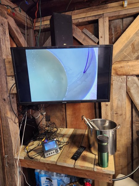

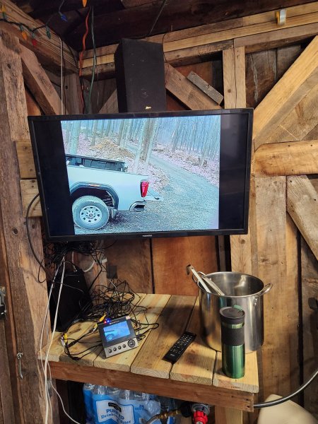

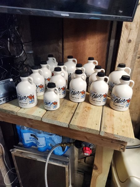

    20230302_113604.jpg Been crazy ! So crazy..no time to post..or hardly sleep. Been 3 crazy huge runs of sap..with little ones in between . Our big runs are bringing in 350 gallons ! We have far exceeded last years total....as we sit...we are at about 44 gallons of 66 brix syrup. We have had all grades..now into the most beautiful redish dark. We are still at 2 percent out of the trees. I must say..best syrup we have ever made. Truly blessed this year! Still in season here...hopefully another week before things get "buddy" but we will see .
    Also picked up a Harbor Freight cctv setup. About $60 bucks for a 4 inch moniter..two cameras..all the cords..and a cord to hook into the tv. No more people pulling in and surprising us...and no more getting up on a ladder to check the ro concentrate tank level. Was the cheaper of all the options. I'm impressed with this simple device!

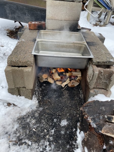

    After a morning of snow removal we’re off again. I’ve accumulated 17 gallons and there’s still buckets to empty at the trees themselves. I wouldn’t be surprised if I get a half gallon of syrup out of today’s work :thumbs:

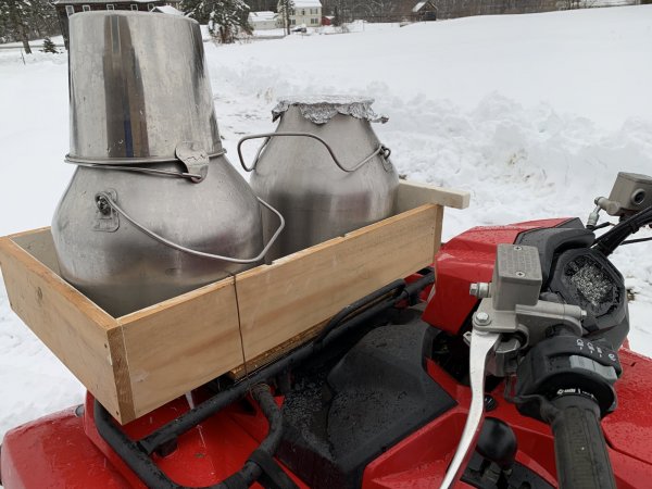

    10-12” of heavy new snow. I’m collecting sap from the barrel using the ATV, carrying the sap in milk buckets. Had 8 buckets worth of sap the past few days- have had ok temperatures but no sun. I’m hoping tomorrow that it will really start to run.

    Like those milk buckets ! Pretty handy setup !

    For a crude first year thing with bare minimal investment, it works for me.

    Dude… I’m STILL boiling :picard: Over 8 hours later… I ended up with 21 gallons of sap so I should get just over a half gallon of finished syrup. I’m letting the fire die down now. I’m going to put it in a 5 gallon bucket, cover it with a lid and pack snow around it, then finish it another day. I’m whooped.

    The first boil I did at about 10 gallons was manageable using this setup. I think even 15 gallons at a time isn’t so bad, but 21 is definitely a long haul. Next year I want to buy one of those reverse osmosis systems to eliminate a lot of the boiling. That’s got to make all the difference in the world.

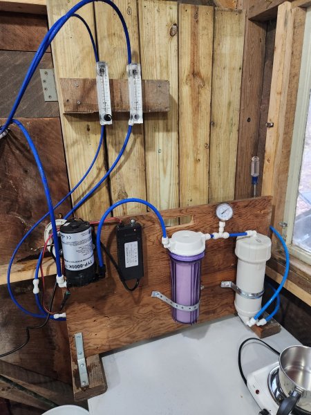

    It does indeed ! Our last run of 350 gallons...was only manageable because of our ro. Upgraded it to do 6 percent out of one pass this year...this is about how much water the ro got rid of out of that 350 gallons of sap..that we did not have to boil. Minus what we used for cleaning already....pretty amazing ! Go Ro bucket. Simple..no guess work...no messing around. Easy to maintain and clean. They have small ones that would be perfect for you !
    Mine was an ro bucket kit...then I added the 5th membrane..and adjustable flow meters this past year. Game changer in time..firewood..and sanity lol. Low cost..low upkeep...huge results !

    The ro stuff seems complicated ..but its actually really simple to operator. And Carl at RO Bucket is great about answering questions anything. Has a FB page for the stuff too. Game changing stuff!
