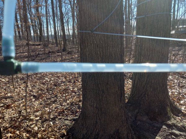

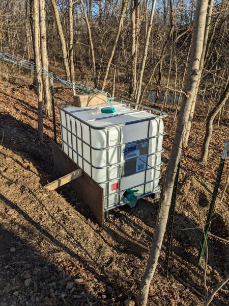

    Tapped yesterday, a week earlier than usual and somehow still late. 50 taps on 3/16 tubing running downhill with natural vacuum. 120 gallons in 30 hours, easiest sap I've ever collected. Can't find, probably broke my sap hydrometer so no idea about sugar content. Sure is nice hear sap just pour itself into a container. 20230211_124102.jpg

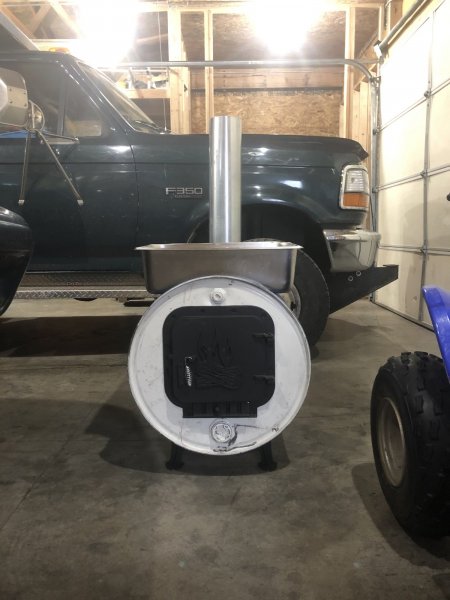

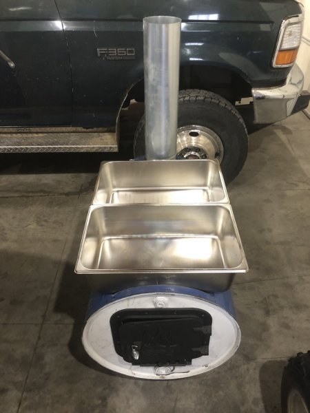

    Been boiling the last week on the turkey fryer, but figured with LP being what it is, I’d better pull the trigger and build a small evaporator. We’ve had a ton of fun the last couple seasons getting into sap, so this get like the next step. Just gotta grab another section of duct to get my chimney a bit higher, and replace the plugs with metal ones….or not. Fire might burn hotter if it can pull draft through those holes once the plugs melt away. I guess We’ll see! 2AC8621A-47B7-40C7-8FAF-940453A9F4B1.jpeg FFF504E2-A8E6-4A2C-AC71-A02A2C2D5D25.jpeg

    Heck yeah take that bottom one out. The more draft=heat the better!:thumbs:

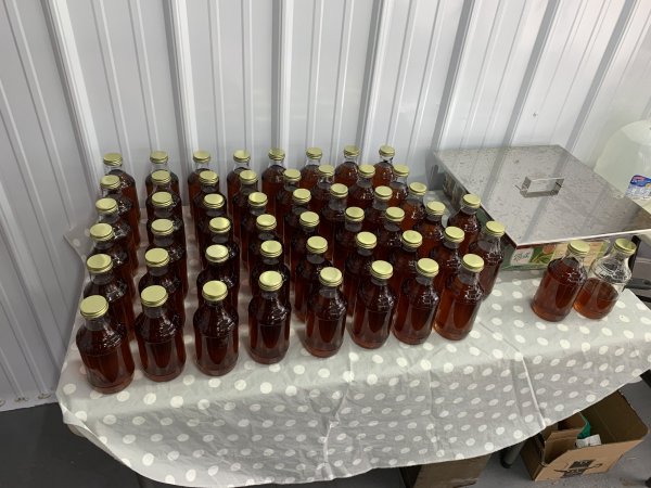

    Boiled out today. Made a little over 6 gallon. Hope the sap starts running again tomorrow. 095D133E-6FB8-4C3B-AEBD-E9C383C9879D.jpeg 7072CF18-2A98-4916-8316-BB36A7154B5B.jpeg 29402106-0777-42EA-8D70-BB927EFF9867.jpeg
