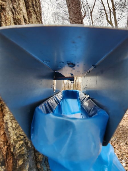

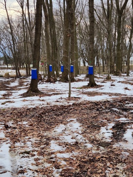

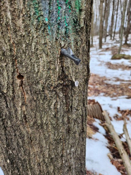

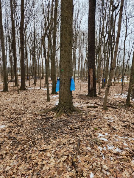

    Tapped all 200 today..with the help of my wonderful family ! Flowing really good today. Let the games begin !

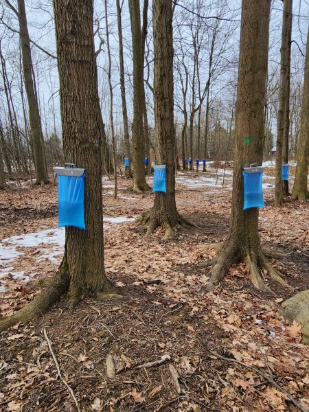

    Got a nice start yesterday afternoon. Today..froze up !! All part of the fun ! Mother nature is the boss :)

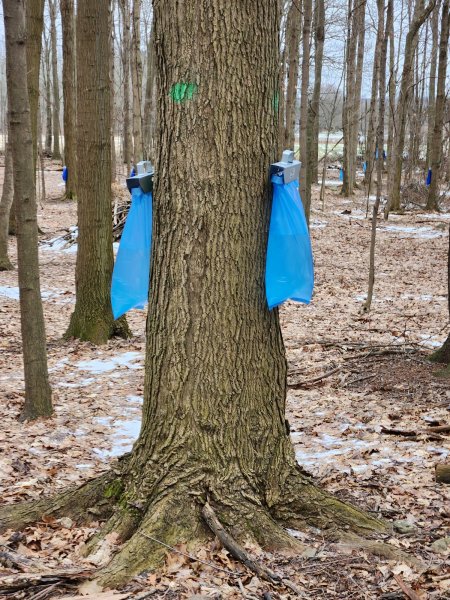

    Did pretty good today off of 200 taps ! Almost 225 gallons off of one 8 hour run before it froze up !
    Now it's running like mad...look out !
    Will be boiling tomorrow..will update sugar content then .

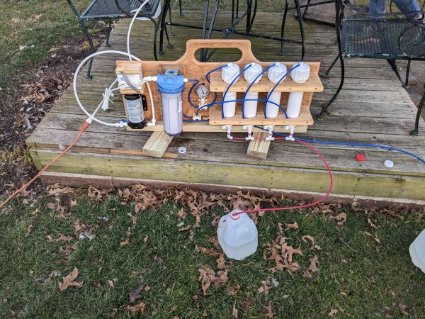

    We are small time compared to some folks, but managed to run about 80 gallons through the RO in 5 hours and netted 27 gallons of concentrate.

    I love that ro holder! Did you make that ?
    Mine is very crude compared lol !

    Yes. Combined a few designs I stole from the internet and came up with this.

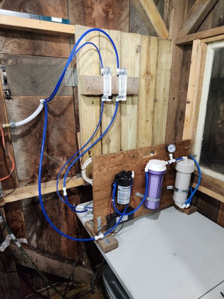

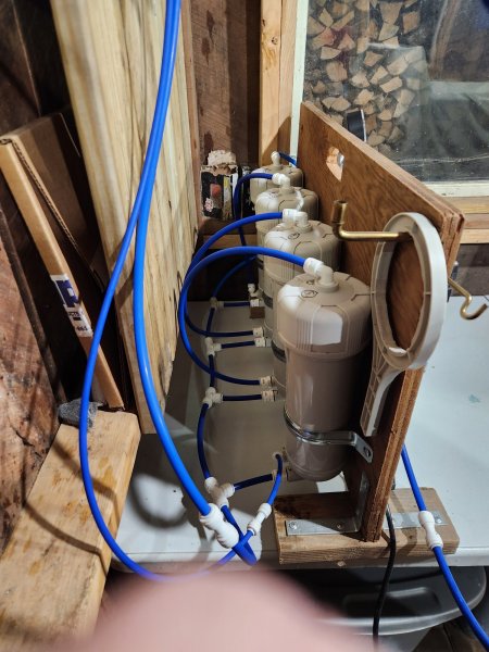

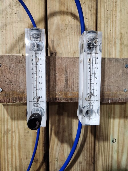

    Got upgraded ro going this morning. All ro bucket.....upgraded !
    Trying out new flow meters to dial it in. Added and extra membrane to make 5 in total...to help
    handle the higher percentage concentrate im trying to acheive. The flow meters are a huge help over the the little valve that came with the kit.
    Out of tree percentage 3 percent.
    Out of ro percentage 7 percent
    20230208_074438.jpg 20230208_055406.jpg 20230208_054608.jpg 20230208_054616.jpg 20230208_051250.jpg

    What % are you shooting for coming out of the RO?

    As far as ro....we typically have 2 percent sugar..so we always just doubled it to 4 percent...and left it at that. We hope for 6 percent now that it's been upgraded ..and able to be fine tuned better.
    So today's starting percentage is 3. We are sitting at 7 percent out of ro right this very second. Seems like a good compromise between higher sugar and decent flow rate.
    In screwing around with it this morning...we tried 8...then 10 percent on accident lol....but flow slows down to a trickle.....and the membranes would last that long that way for sure. So we are thinking the 7 isn't too greedy. It's all an experiment!
