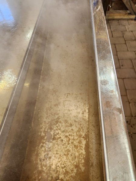

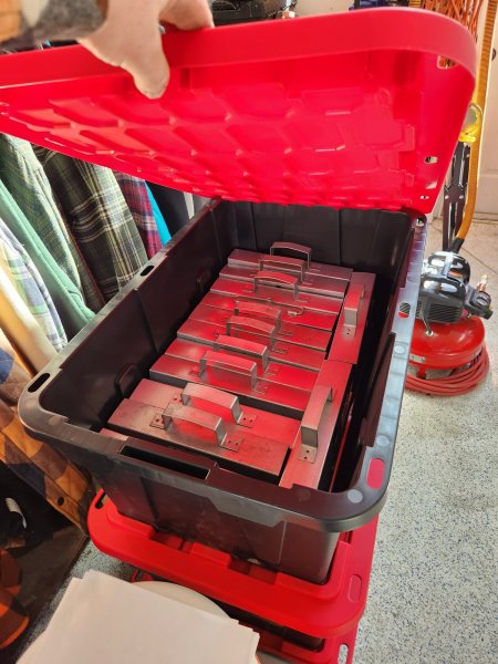

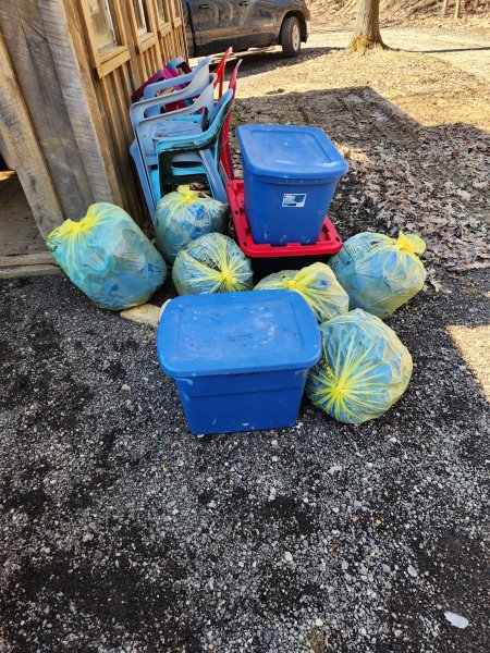

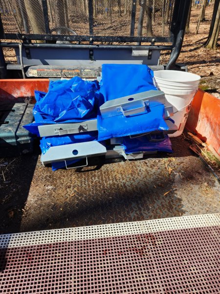

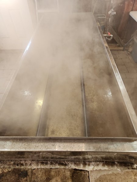

    Bottled the two gallons from yesterday...then...
    Saved about 200 gallons of RO
    permeate water from the other day..to aid in our cleanup.
    Filled the pan all the way up with permeate..and a couple gallons of vinegar..got it to a boil..shut her down. The scum and crud was just breaking off with the boil !
    Then....we went out and collected sap sacks and pulled taps. Disassembled everything back at the shack. Threw bags away. It's alot of work at the end too lol !

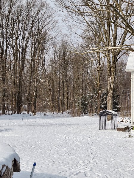

    Snowing here most of the day so sap didn’t run.
    snowbank around trees keep them from budding too soon

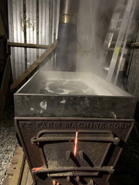

    Quickly!
    My arch (an arch is the heating part of an evaporator) was built over 100 years ago, but the design endured into the early 80’s as the predominant style. Two hinged cast iron doors. You typically open one side and add wood, close it and then open the other side. The idea is to not slow down the boil by allowing a lot of cold air in.
    At some point they started to insulate the inside of the doors (mine aren’t). Then they went to a single door with airtight gasket (my newer arch has that style).
    Air comes in under the fire and up through grates. Blowers have been added, and are referred to as air-under-fire (AUF). Years later, they began applying forced air that comes in over the fire through a series of nozzles (AOF). This is like a secondary burn on steroids, and can increase the efficiency up to 35%.

    Flamestead is that a solid pan? Most is old ones I’ve seen have separate areas think dividers so the one in front you draw syrup off while still adding sap to back gravity fed as syrup is denser than sap

    Yes, the pan is a modern-day SS welded flat pan with no dividers on the old arch I’m using now.
    I’ll try to get some decent pictures of my newer evaporator (in storage until I build a proper sugarhouse). My rear pan is a raised flue style. There are flues that are raised up into the pan, running from front to back, to increase the surface area exposed to the fire.
    The company that made the arch I’m using this year first got their start making a rippled/accordion bottom style pan for cooking sorghum to syrup. Those pans initially went on a brickwork arch. The company moved to Bellows Falls, changed their name to reflect being in Vermont, and soon began making maple pans. They closed the doors in 1922ish, so my arch is at least that old.

    I absolutely LOVE that old arch ! I'm jealous !

    Don't ever get rod of that . That is just freaking cool !

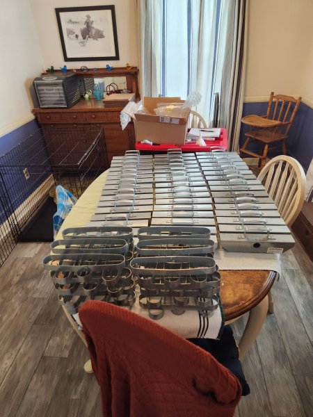

    Great weather to clean up everything after a long productive season. Cleaned the taps already..now on to the sap sack holders. I scrub and rinse with the warmest water my hands can stand. Mapke sap is acidic....so I treat it like when I soak stuff in vinegar or citric acid. Rinse..rinse..rinse ! Rinse away the gunk...and dilute ..deactivate and rinse away anything corrosion. Hopefully these will last for the next generation...if they care about this at all !
    And don't mind the mess. We have about 10 other things going on always..including dehydrating bananas slices !
