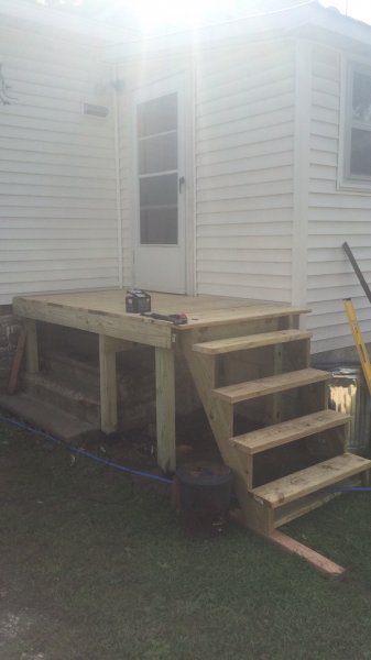

    I blew the budget completely because I didn't use pallet lumber so it is getting a serious change. :hair: Mrs Pallet is all excited non the less. :thumbs: Instead of a breezeway I am going to have to make it a small landing to make it easier to enter the house. The breezeway will have to wait till next year now. Once I got going she asked me to change the plan after Mrs Pallet face planted last year due the steps continuing to break away I cant blame her one bit....
    This project just got boring!:emb: Lumber is expensive!:doh: I I cant afford the case of beer that is grandfathered in to every Pallet Pete Project budget now!:cheers::rofl: :lol::hair:

    Well it's too tall for the local hardware stores Home Depot lowes ect so time for UPSIDE DOWN stairs!!!

    I would never get away with a stairway as steep as the one you built but otherwise it is looking good. Mrs OM47 insists on a maximum of 6 inch tall steps because of her rheumatism.

    Its temporary I couldn't find a stringer long enough so I had to flip one to make it work. I agree defiantly too steep. Im going to order a new stair stringer the right size or make one depending on price but in the mean time we need something:whistle:

    Try this. Set a 2x12 raw stringer, no notches, at the angle you want then nail or screw small, foot long or less, blocks of 2x4 at the right height and spacing for your final rise and run. After that it is a case of nailing some 2x4 or 2x6 material to the top of those blocks. My rear deck is about 9 feet off the ground but I have a nice 3 foot wide stairway to it that is nothing more than a few 2x4 blocks screwed to some 2x12 stringers and some 5/4 treated decking material on top of the blocks. By not cutting the 2x12s the stringers are far stronger than you will typically find and the only cuts needed are the ones to make the top fit the edge of your platform and the bottom cut to make it sit properly on the ground.

    Right about getting new steps. Those steep steps are just trading one problem for another. What are the 4x4's resting on? The only other concern I have is I noticed the bottom of the door is nearly level with the deck surface. If you get any accumulation of snow and ice, you won't be able to open the door. How to Build Porch Stairs

    The Idea is to put a roof over the porch before winter so the deck will stay clean. Its protected pretty goo in that little pocket. The 4*4 s are set on gravel and the ground is clay they wont go anywhere in that soil.
    As for the steps I have all the measurements to cut the risers I am too busy to do it right now and would rather buy them its faster.:whistle::whistle:
