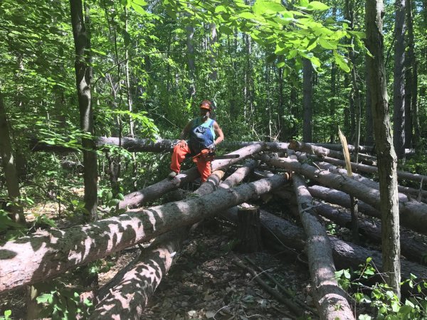

    Stack rummaging is a constant. That's why I just flitch and pile separately most the time. Don't have the time or patience!:mad:
    That pile of pine looks like a good pile of dimensional lumber already! Those Mills make fast work of it.
