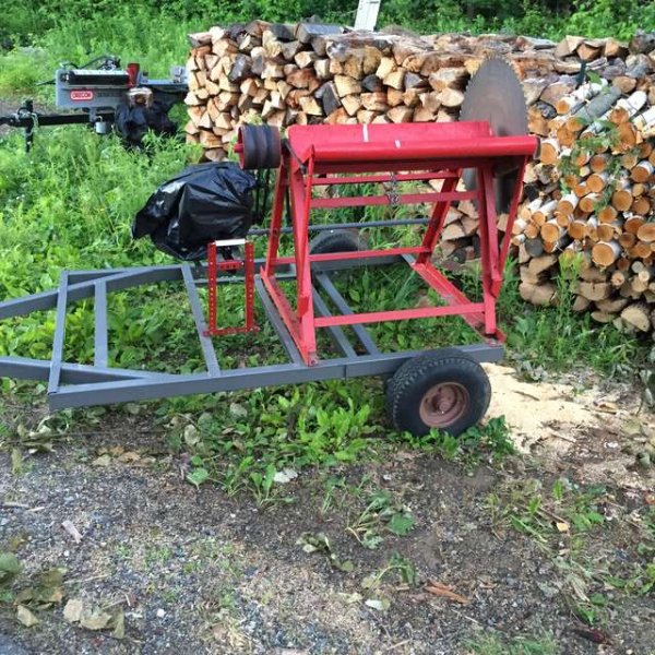

    1A. If it's under 6" (Saplings and branches) I try to cut them into 8' lengths and then I process to 2' lengths using my cordwood saw:

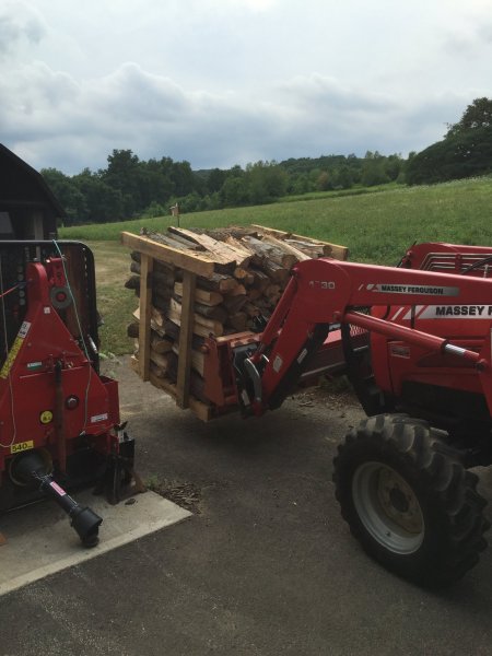

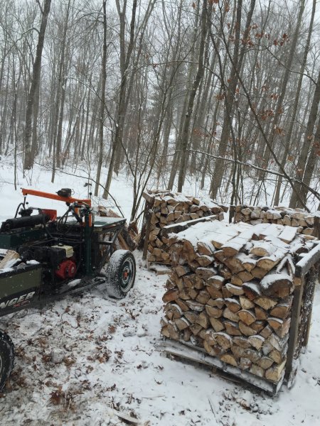

    2. In either of the 3 methods above, I stack them right away on a 4x4 pallet and leave them right there to season.

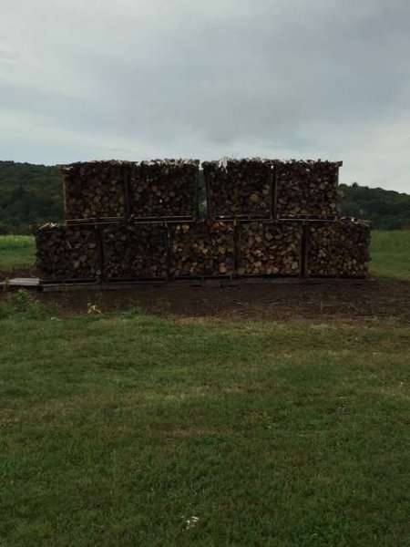

    3. Last year, I moved most of the pallets to a central location where I would grab them as I needed and bring them to the boiler...
    ...but this year I just go pluck them out of the woods and bring them right to the boiler a couple of pallets at a time. This is good because I only move the pallet once, but if we got buried with snow, getting some of my stacked pallets out of the woods may prove to be challenging. Time will tell. Either way I have to keep a list of pallets (they are numbered), when they were filled (so oldest gets burned first), and a map as to where they are on the property!
    Nice cordwood saw, seen one of these before and fear is such a small word. I just want to ask again as you say small branches and limbs, how much in diameter is this rated for?

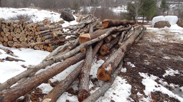

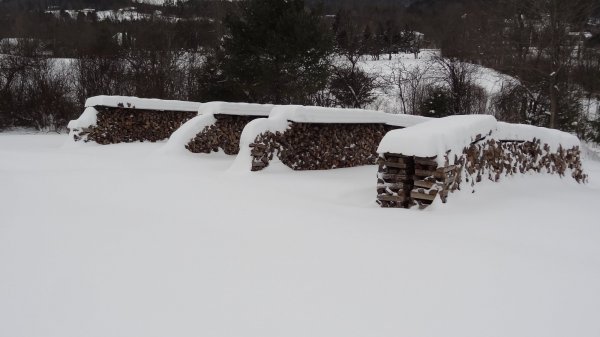

    My processing isn't ideal, but it is what I've got...
    We are improving our woods by removing the junkier trees, leaving saw logs and Sugar Maples. The wood gets skidded down off the hill to the processing area, which used to be a gravel pit. As you can see, I don't bother much with branches - they get left behind to rot back into the soil.
    I'm also leaving behind the gnarlier pieces. No noodling here - takes a bunch of time for what I get out of it.

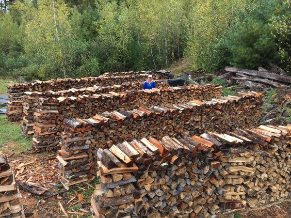

    I rotate where the logs get piled among three spots - the other two spots will have stacks that are drying...
    The wood is cut to stove-length, split, and stacked right where the skid is dropped. We do no cleanup of sawdust, bark, or splitter scraps. The two pictures below are of the same season in the rotation...
    Finally, in the Fall of the season it will be burned, we move it into the woodsheds by trailer. This is the step I think will be improved next, probably with a pallet system like some of you have shown. I've avoided double-row stacking to speed drying, but as I get to and push beyond a three-year cycle that is less of an issue, and a pallet moved from the drying area into the woodshed would probably work fine.

    It'll cut anything you can lift; you may have to hit it from both sides, but it's pretty good for cutting anything you want to throw at it. For me, 6" or so is comfortable for me to handle at 8' lengths. I cut to 24" so that gives me 4 chunks per length. I've cut larger diameters, but it starts to get cumbersome and I have other equipment to process larger diameters.

    I would say so! Looks like the bigger they get the vibration becomes a bit more and gets difficult to hold steady.
