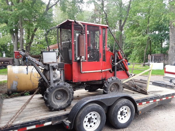

    This is a 10K tilt bed that I use for hauling equipment & cars. Could easily add a winch, but if I have to pull something up it I just park the skidder next to the truck & pull it on. Note the stake pockets & tie downs. I do have a 12' dump trailer as well. Yes to brakes on both axles & 10 ply tires as well. 20190830_140557.jpg

    What is that equipment on the trailer called? Looks like a mini skidder. Have researched how to harvest trees (blowdowns, dying trees, trees to thin) on my land, that is interesting, looks smaller than a skidder.

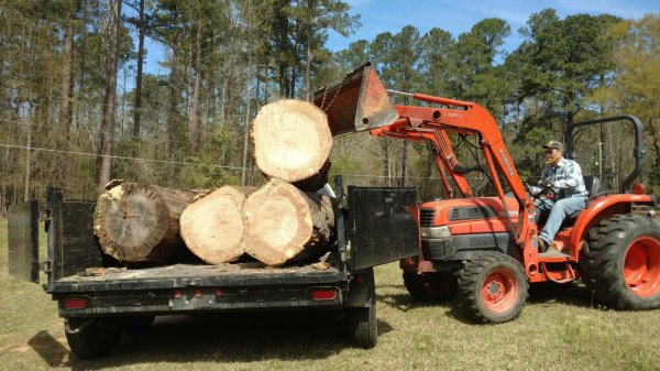

    We have a 7x12 10K dump trailer with ramps, it will haul 30hp Kubota with FEL. That is what we log and load wood with. IMG_20190319_123014984.jpg

    That's cool, is that the 30hp tractor? That one sure looks bigger than 30hp. Do you have any more pics of that trailer? Was it store bought or home made trailer? The trailer seems to be higher off the ground than I would expect but maybe it's just the angle. Looks like a real nice trailer. Are ramps built under or where are they? Thanks!
