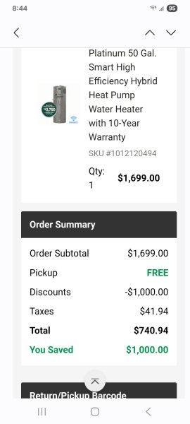

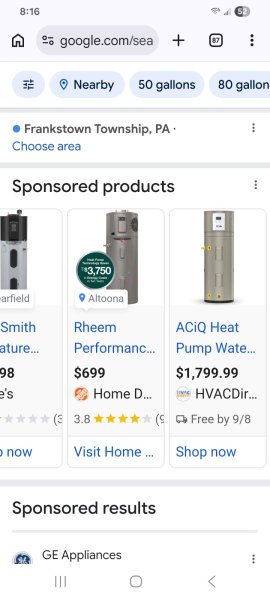

    So my EcoSmart 27 electric tankless water heater went out last Saturday late afternoon, and I've been wanting to try a heat pump water heater, so I googled them and an ad for HD popped up showing them at $699.
    So I tried to get it in the altoona store, but it wasn't actually in stock. So I was able to get one in Johnstown. About 40 minutes away. Picked it up Sunday morning and commenced to putting it in. I set it up near the woodstove and electric panel. Had to run some new pex lines, put in a 30amp breaker, and luckily found some 10/3 cable here. (Didn't actually need the neutral wire though. )
  2. TurboDiesel
    16,238
    97,544
    This is the 4th Rheem heat pump water heater I've installed and I would recommend this unit. It has a 10 year warranty on parts and I can't believe it was $1000 off! :jaw:
    Screenshot_20260823_084433_Email.jpg :dex:

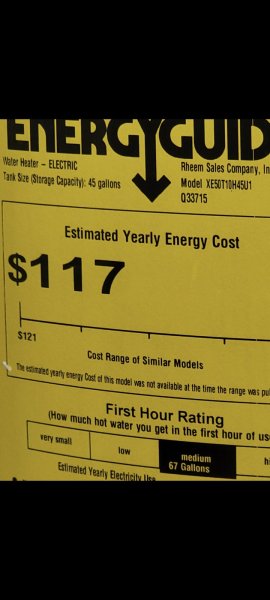

    The Energy Star tag claims it cost $117 per year to operate.

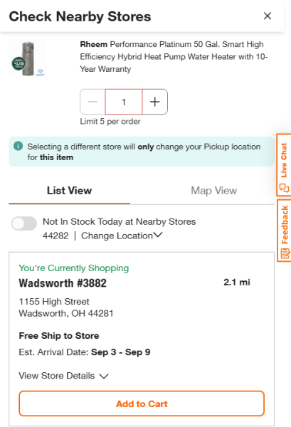

    I couldn't find that price at any local stores...HD is weird about that.
    You can usually buy at the sale price using the correct store #, then pick it up at the local store, at least used to be that way.
    You are correct about the temp drawing down in the summer...feels good though, as the humidity is lower too. The temp will be largely unaffected when the stove is on.
  7. brenndatomu
    25,034
    162,547
    That price still works using the Johnstown store...and still shows 1 in stock. And can buy for $629 if buying 3 or more! Still $1699 locally...but looks like it can be delivered for as low as $55.
    So this is like it was in the past...you buy it from HD xxx location, then pay for shipping to your house...or I think there used to be a free option to pick it up at the local store too...yup, there it is...looks like I buy up to 5 of them to be delivered at the local store for free. Hmmm...
    Edit, nope, can't buy in PA store and pick up in OH...the price goes back to normal when you try...rats!
