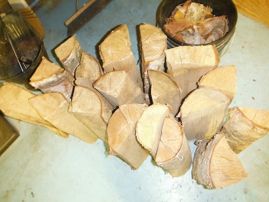

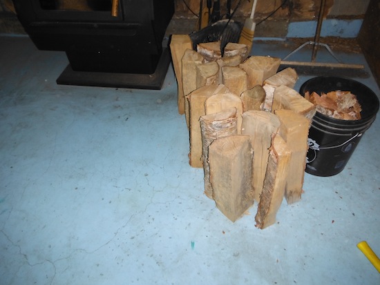

    Loading a new load last night , 10 :00 , warm stove with a few hot coals:
    Get an approximate amount of wood ready

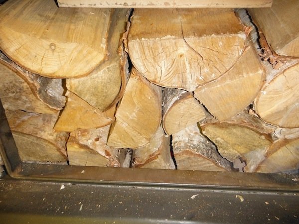

    Load the stove full, 1 piece didn't fit:
    Throw in some bark in front of the wood & light. Door open about 2"
    Birch bark start a roaring fire in a couple minutes.

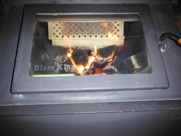

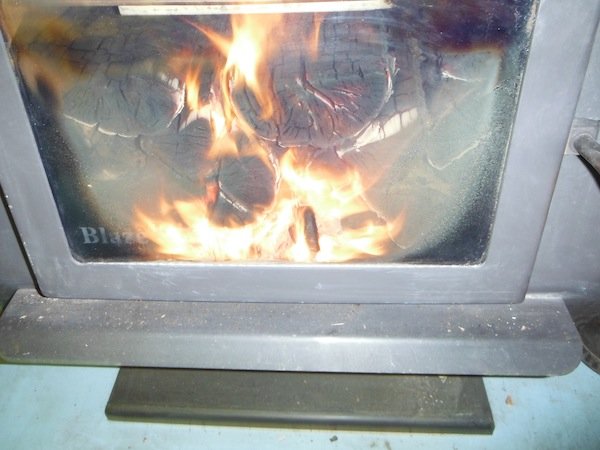

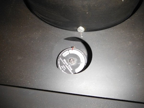

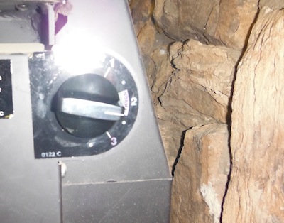

    Adjusting for a long burn
    Burn on high, then med high until cat up to mid range temp
    Turn Stat down, flames go out then adjust stat to just above 2 for night temps around 26°, no fan
    Combustor glowing hot
    This morning around 1030, lots yet to burn, cat in good range.

    Nice overview of a B.K.K. burn.
    Couple of questions if I can ask Dave: Is that birch? How long before you closed the by-pass and turned the draft down (after loading that wood)?
    Just going by those photos, including how clean the glass is, I would guess that is what I would call a 'medium' burn; I assume you can turn the stove well down from there and still get a full cat. burn with no visible smoke?

    Actually I'm on what I call medium low .
    My setup , 1.75 the flapper is shut. I think being close to the wall, stat chamber stays pretty hot.
    Fans running will change it a bit & I use the same setting for around 20° with fans just above low speed.
    So not much of a lower setting, (1 is about the same as 1.75 , don't see much difference but only burned there a few times over the years) .

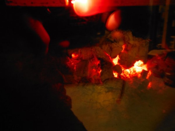

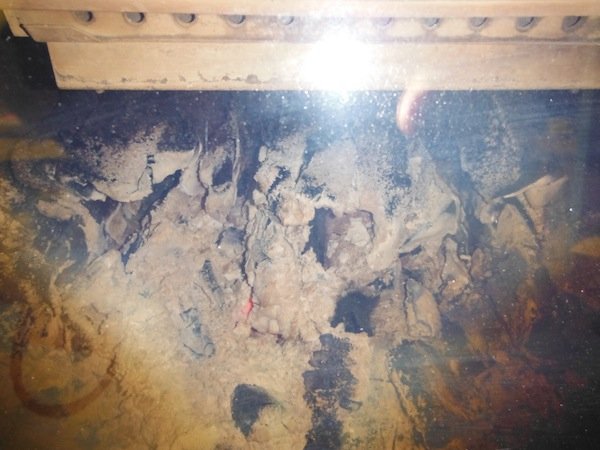

    Been 24 since last night's load. Tonight's load up to temp stove set.
    Full cycle of a full load .
    After 23+ hours:
    before raked...../....... after raked
    Tonights load , a little higher setting (2.2) & fan medium. 14° , wind 15 to 20 , mostly cloudy

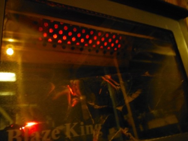

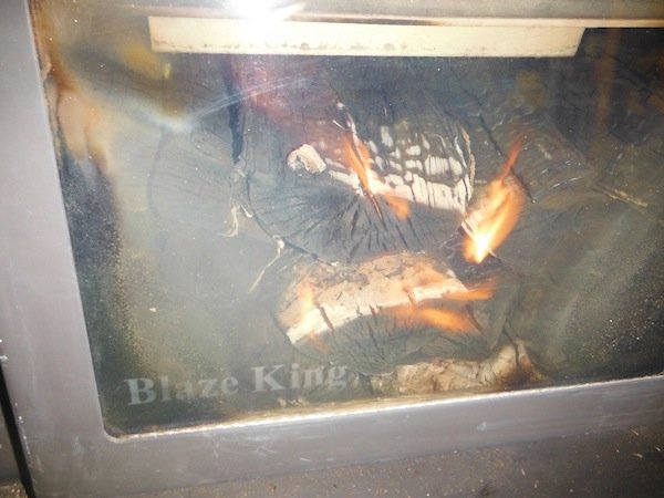

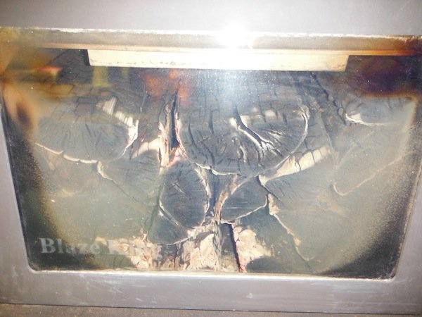

    Yea it holds lots of wood, amazing to me is how so little flames yet so much heat output for so long.
    Catalytic is hot & glowing & little to no flames.
    Last nights load:

    That belly is pretty full of ash. My princess looks like that and you have several more inches of belly depth before you hit bottom on the king.
