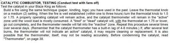

  7. bogydave
    37,220
    If it's not falling out .
    I'm not sure.
    I know the center section of my ceramic fell forward, not out,
    just to where it touched the flame shield / protective cover
    Manual don't have much:
    Testing:
