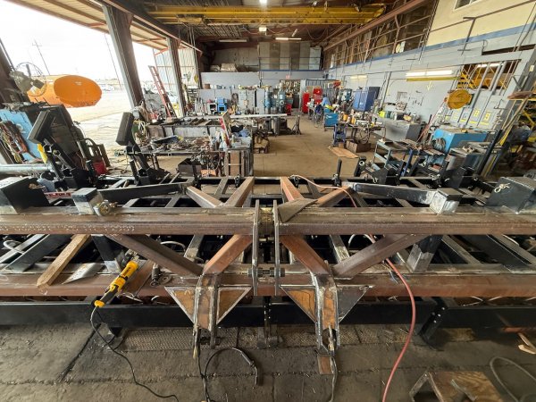

    This is the weld shop, south half of the shop. Not too cold due to sun and hot work.
    The machine shop on the north side is cold. SoCal cold anyway. Think a double barrel will take the chill off in the morning? Ceiling is awful high…

    We have some kerosene burners and they only warm the immediate area.

    Too much volume...you won't even feel it unless you are nearby

    For that shop you'll need 2 Grandpa Fishers! Barrel stoves won't touch that place. Do a calculation of area/sqrft, that'll tell you what you have to heat!

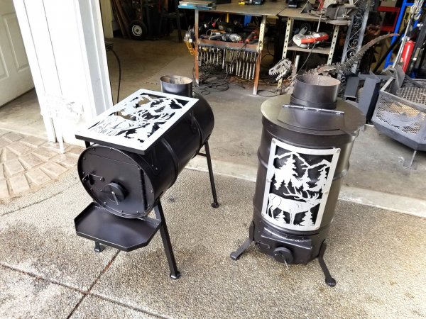

    Hey Deadwood, Nice looking start on your stove! Did the door kit come with a gasket? If not, caulk under the door flange with automotive muffler cement before bolting and it will go a long way helping the air tightness of the stove leading to longer controlled burns. I would definitely put an arc of firebrick on the bottom and 1/3 of the way up the sides to prevent the iron being burned away or sagging. Don't forget brick on the the back of the stove. If your shop or garage does not have high ceilings and a huge amount of square feet, your single barrel stove will heat great. You can also gain a lot of extra heat from your exhaust pipe depending on how long it is and how you route it. The biggest threat to barrel stove life is water or a damp environment. If you keep the exhaust pipe and roof penetration and stove cap tight and free from leaks and drips, the stove will last longer than you would think! I have built a lot of barrel stoves large and small. Some for shops or barns but most smaller and more ornate for elk camp tents and cabins. Here is a couple I have done. Don't forget a warming shelf next to the pipe collar for perking your coffee and keeping it warm! Wish you the best of success on your installation!
