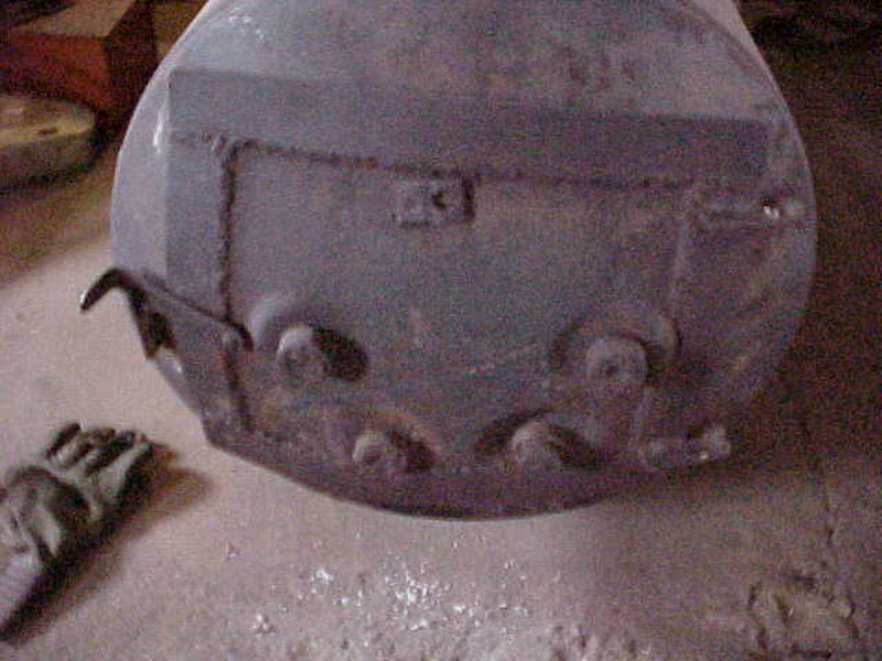

    Hey EstoParatus, there appears to be no air adjustment on the door of that stove? Is it under/below the door?

  3. Deadwood
    Deadwood
    Jan 28, 2017

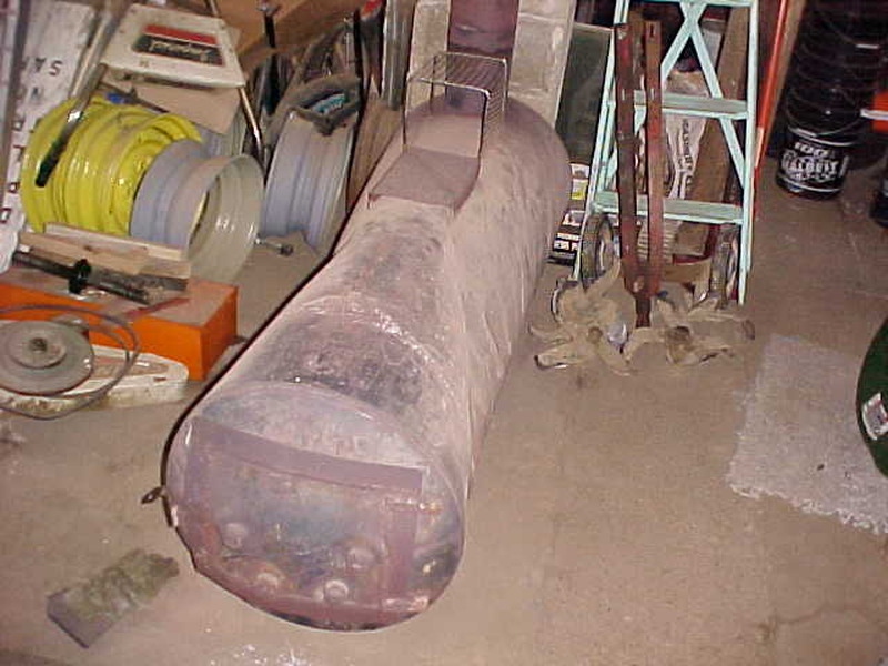

    321
    1,170
    Under the door. It's there.

  4. Deadwood
    Deadwood
    Jan 28, 2017
    321
    1,170
    You can see the door in this pic.

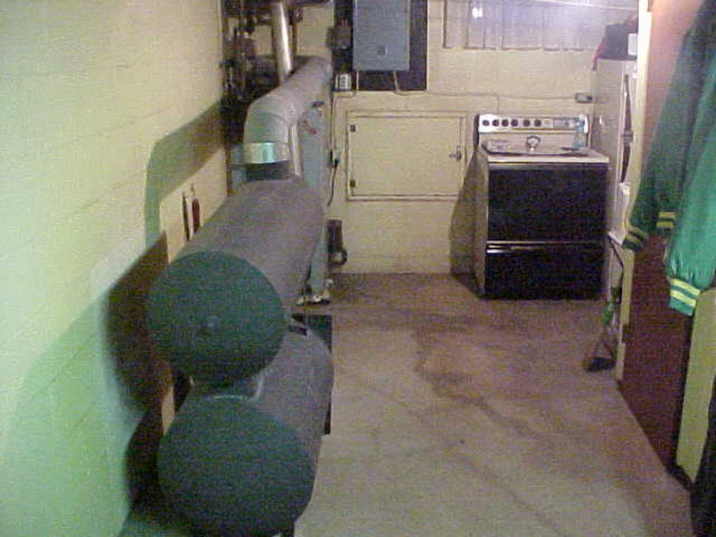

  5. Kevin in Ohio
    Kevin in Ohio
    Oct 15, 2014
    1,067
    6,287
    Keep your eyes open for old Pressure water tanks. Try to avoid Galvanized versions but the sidewalls are normally at least 1/8" thick. Dad made his up and used an old coal furnace door for an opening. It's been his heat source for 40 years now with no issue. Oil Furnace has not been used.

  7. Kevin in Ohio
    Kevin in Ohio
    Oct 15, 2014
    1,067
    6,287
    All I know is it works VERY well. That stove will cook you out of the house and takes about 6 cord a year in Ohio. The flue design is an easy clean. Normally twice a heating season he cleans it by taking out 2 screws and lifting the whole horizontal section off and out of the house. Tap the end and buildup falls out. Looks like black snow crystals when it builds up. Chimney stays completely clean. First few years he put a light at bottom and no build up so didn't clean. After 15 years he decided to do it and got about a handfull after a 1 hour of us running a cleaner up and down. All I know is it extremely well matched system for his needs. Wood is stored from an outside fed storage. You can see the door in the wall. Holds about 3/4 of a cord and keeps the bugs and dirt out of the house and they don't hatch before it's too late.

  18. Kevin in Ohio
    Kevin in Ohio
    Oct 15, 2014
    1,067
    6,287
    Here's another that may be of interest to you. Dad made this one up from a tank or water heater that someone dumped along side of the road years ago. He used a circular saw with a metal cutting blade and cut a square out of the top for a door opening. Then welded strap around the cut out piece for a flange. Some other scraps for legs, hinge and door latch. We did some "testing" on it to see if we could melt it. We fed in super dry cedar shingles and dry lumber scraps and left the door wide open. It was huffing and puffing and was creating such a draw it started to suck the sides in but did not fail. It's 1/8" thick steel. Came in about 4 inches on each side. It's in an old building now and still used in the winter to keep warm.
    Not much to look at but it'll keep you warm!
